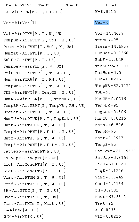

Functions list: AirPTWV(), AirPVWT(), AirTVWP(), AirPTW(), AirPTF(), AirPWD(), AirPTRW(), AirPTWR(), AirPTWB(), AirPTBW(), AirPBWT(), AirPBRT(), AirPTWU(), AirPTUW(), AirPTWH(), AirPWHT(), AirPHWT(), AirPTWS(), AirPWST(), AirPSWT(), AirVapPT(), AirVapTP(), AirCondPTH(), AirCondPTS(), AirPTWM(), AirPTWK(), AirPTWC(), AirPTHs(), AirPHTs(), AirWX(), AirXW(), AirVer().
Dependences: Mathcad EFI plugin.
Short description:
[albumimg]252[/albumimg] [albumimg]251[/albumimg]
Links:
1. Mcdair32.dll you can get from here: @Air 4.0 (or from archive below).
You must manually copy the Mcdair32.dll to the userefi folder (".../Application Data/.../91a20d24-c30b-4774-9b1b-4d502a80420f/x.x.x.x/userefi/" ) and TAir32.dll to the \windows\system32\.
air.zip (81 KiB) downloaded 157 time(s).
Short description:
AirPTWV - [Mcdair32.dll] [ P, T, W, UnitSet ] returns the specific volume
