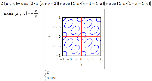

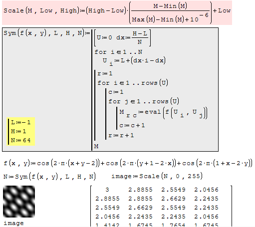

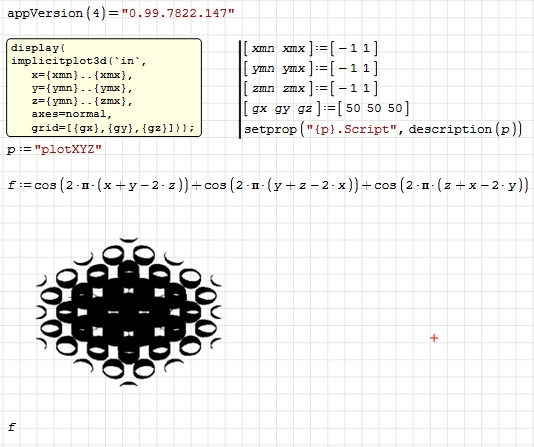

#3 Posted: 7/9/2021 4:34:15 PM
Alvaro Diaz Falconi
Alvaro Diaz Falconi
992 likes in 1675 posts.
Hi. You can try this:
maple_implicitplot3d.sm (7 KiB) downloaded 62 time(s).
Also, can read more about maple complement here.
