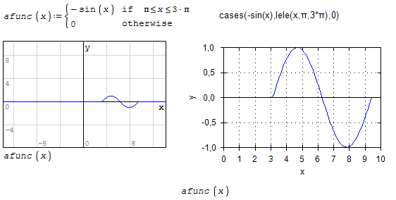

The sample code shows what works and what doesn't. I think the issue is in zed_graph as 2D works. It stops working when the if is added to the function zedgraph example.sm (151.36 KiB) downloaded 1368 time(s).
#2 Posted: 12/21/2019 6:09:32 PM
Seems that Zedgraph can't handle if(). It also fails at non-numeric or undefined values.
A workaround for if() is the use of cases() from Customfunctions plugin. It converts into a boolean expression, which can be handled by Zedgraph.
Suppressing parts of a curve by making it undefined doesn't work. You just can set it to zero.

zedgraph%20example_Kr.sm (34.05 KiB) downloaded 1637 time(s).

#5 Posted: 12/22/2019 5:20:26 AM
Hi Jean
The example I gave was to highlight the issue. I am plotting protection functions, these are very much piecewise functions.

#6 Posted: 12/22/2019 5:24:19 AM
Hi mkraska
I really like the afunc syntax and I am sorry but Newbie I am. How did you get the if after -sin(x)
#7 Posted: 12/22/2019 5:43:33 AM
Hi mkraska
worked it out. types in cases; thank

#8 Posted: 12/22/2019 10:01:57 AM
WroteHi Jean
There is no issue: you can plot contiguous pieces of same function,
or any selected pieces. You can have as many different functions
as you wish of both styles.
Please, revisit just new "2D plot Piecewise" in Samples.
#9 Posted: 12/22/2019 7:20:34 PM
Hi mkraska
I stuck with zedgraph,
curves_example.sm (60.24 KiB) downloaded 1353 time(s).
I think the results looks pretty good, thanks again for your help and the custom functions.

#10 Posted: 12/22/2019 8:54:22 PM
WroteI'm stuck with zedgraph,
... freak here too.
Native Quick plot is as well educative.
curves_example Native QuickPlot.sm (88.78 KiB) downloaded 1380 time(s).
