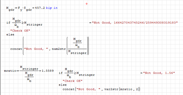

1.Can an if/then return a string AND calculation result. I have not be able to concatenate this in any way.
What about:
concat("result is ",num2str(value))
If you use Custom Functions plugin you can use even:
concat("result is ",var2str(value))

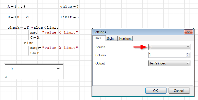

2. Can I have a combobox as part of an if_then function? If one condition is met, use one combobox, otherwise use a second.
Yes you can have it

Thanks for reminding me, when i tried to use concat, i forgot that it was for text strings only.

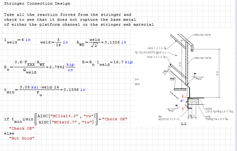

Here is an example of one application- I am checking historic building members, and if they are overstressed, I want to know by how much.
using num2str, I get a fraction as a result.
if I create a variable, then using var2srt(2) I can control the output format. I would prefer to not have to define the variable, but its workable.
so the conclusion i am getting is the error is in the argument, not the if/then function. here I am using the custom functions with max function
Thanks again
