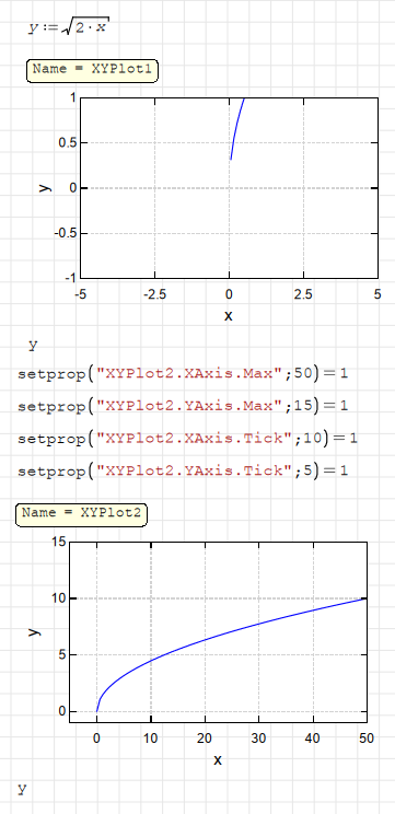

I am completely aware that the documentation said that you cannot adjust the axes limits when using vanilla plot function. Is there a plugin that is able to resolve this issue?
Or rephrasing; is there an available plugin that allows users to plot functions and adjust the axes limits of the plot?

You can use XYPlot and setprop() function for that purpose.
Here is sample file for setprop function.
setprop.sm (21.36 KiB) downloaded 1565 time(s).

As a note: the 'name' of the graph (in this case XYPlot1 and XYPlot2) is specified via the XY-Plot Properties (i.e., double-click the graph to see the full list of properties); one of those fields is called "Name" which would be the title to reference the Plot through the 'setprop()' command.
