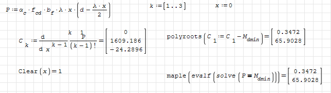

Good morning, I'm new to Smath Studio, I would like to know if it is possible to obtain the same result that was obtained in mathcad prime 6.0
math cad prime 6.0
https://i.ibb.co/S76VZZY/mathcad.png

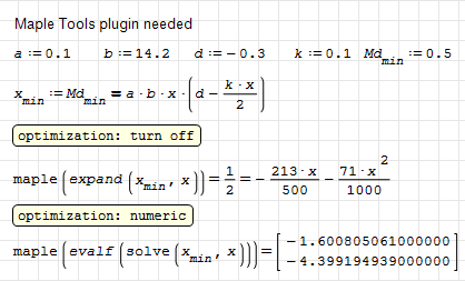

I need this display after the expand
https://ibb.co/Sfmj1jz
#7 Posted: 12/9/2021 1:07:56 PM
TIAGO C DOS SANTOS
TIAGO C DOS SANTOS
1 likes in 27 posts.
Hi Tiago. This is one way.
I need the blue rectangle to be the same as the yellow one, is this possible?
https://ibb.co/2n6Np5C
#16 Posted: 12/10/2021 5:04:29 PM
554 likes in 1333 posts.
i need to show the students step by step how to perform the calculations
What construction/calculation step by step ?
Not possible to easily write all those functions in one line.
It can be done with serious alterations but shall not be practical.
I posted something similar to another user. But again, I wouldn't use it.
Just write functions and solves in multiple lines.
