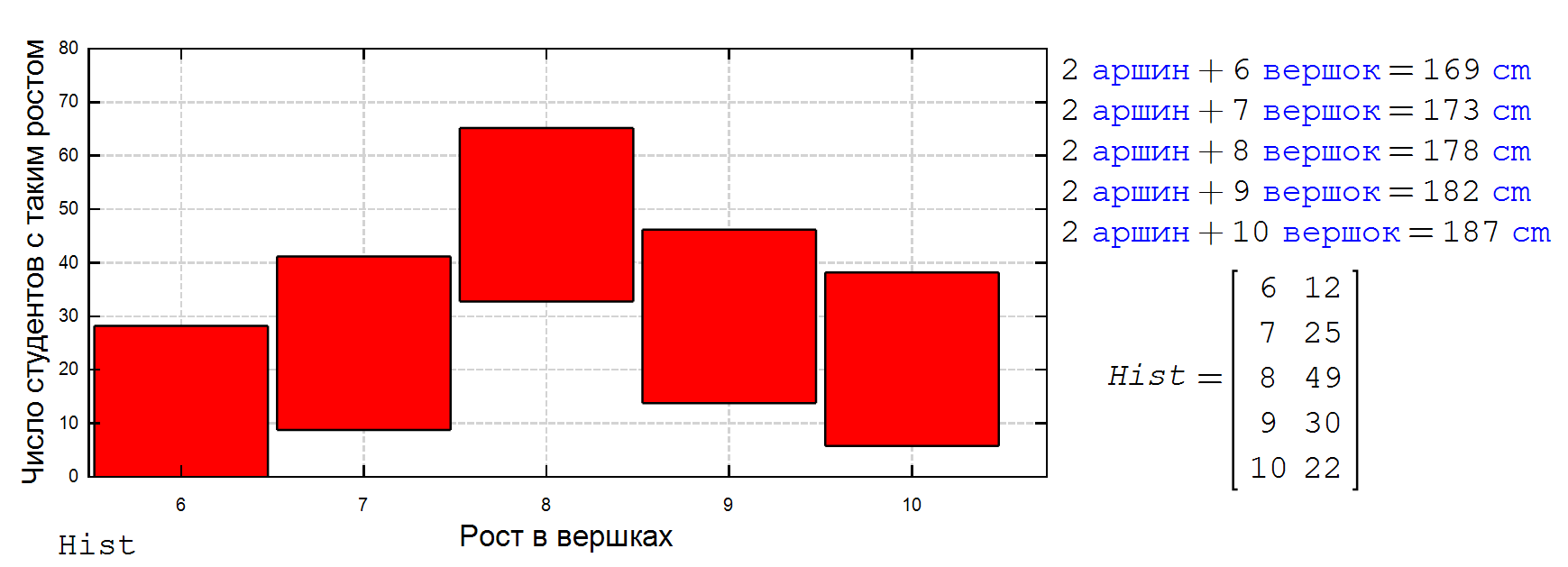

#1 Posted: 10/10/2023 6:22:41 AM
Valery Ochkov
Valery Ochkov
55 likes in 633 posts.
Mister-Class.sm (51 KiB) downloaded 77 time(s).

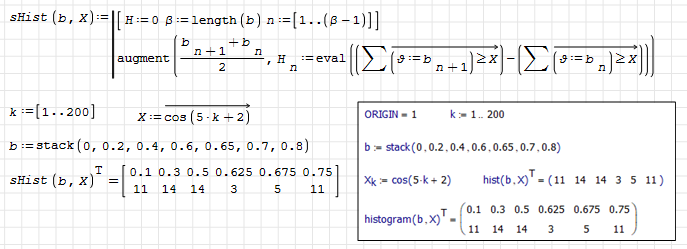

#2 Posted: 10/10/2023 11:36:23 PM
Alvaro Diaz Falconi
Alvaro Diaz Falconi
992 likes in 1675 posts.
Hi Valery. This function returns the same result as mathcad.
sHist.sm (15 KiB) downloaded 69 time(s).

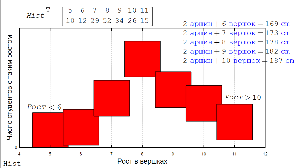

#3 Posted: 10/11/2023 5:25:07 AM
Valery Ochkov
Valery Ochkov
My students histogram

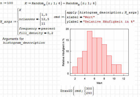

#4 Posted: 10/11/2023 7:42:53 AM
1226 likes in 2151 posts.
Maxima has a histogram plot function.
Taken from DOI: 10.25933/opus4-2949. The PDF has attached SMath documents.
Valery Ochkov 10/11/2023 8:23:00 PM, Oscar Campo 10/11/2023 9:42:00 AM

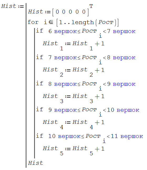

#6 Posted: 10/11/2023 2:43:40 PM
Alvaro Diaz Falconi
Alvaro Diaz Falconi
Hi. This version also works with unequally spaced bins.
pHist Mister-Class.sm (61 KiB) downloaded 74 time(s).

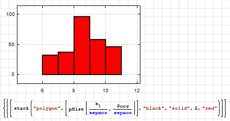

#9 Posted: 10/12/2023 4:48:09 AM
Alvaro Diaz Falconi
Alvaro Diaz Falconi
Hi. You can use the above pHist within XYPlot.
