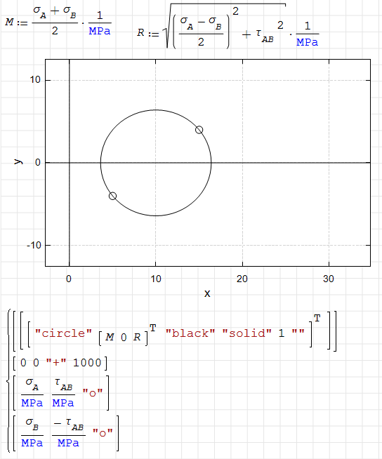

#5 Posted: 3/14/2022 1:06:17 PM
Here is a version with pre-defined geometric object in the XY plot plugin. See Handbuch section 8.3.4.
MSS_Kr.sm (13.86 KiB) downloaded 1209 time(s).

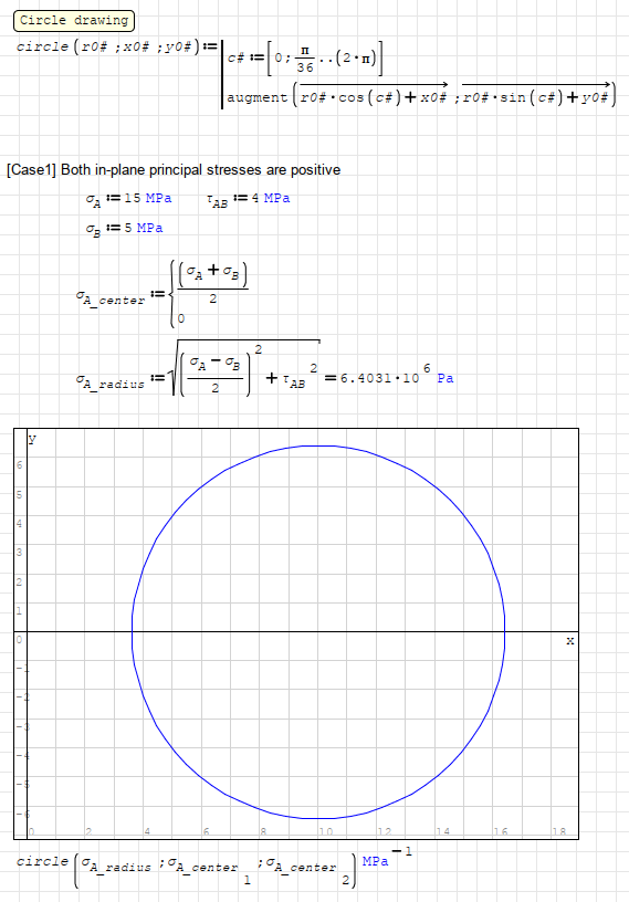

I have succeeded to draw circle on the tutorial but not mine.
There are many ways to plot circles wrt applications.
My most used brew ... Cheers, Jean.
Page4 Circles_Ellipses.sm (9.36 KiB) downloaded 1351 time(s).

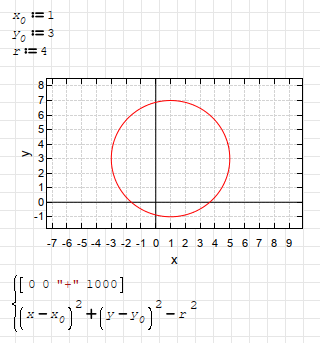

#9 Posted: 3/15/2022 1:22:17 PM
598 likes in 1,380 posts.
Thank you all. I appreciate your help
It is much easier to draw circles with X-Y Plot plugin.
circle_xy.sm (5.23 KiB) downloaded 1259 time(s).
