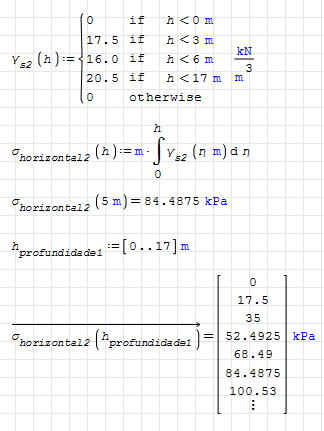

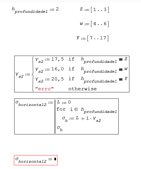

Good afternoon, could someone explain to me how to solve this problem I need that the horizontal voltage varies according to the depth however and the s2 gamma.
my input data is hprofundidade1 z w and y
TESTE TENSAO ADM MATRIZ.sm (5.41 KiB) downloaded 1162 time(s).

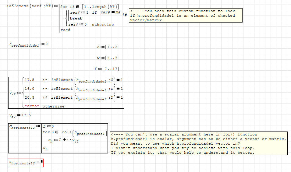

WroteGood afternoon, could someone explain to me how to solve this problem I need that the horizontal voltage varies according to the depth however and the s2 gamma.
I didn't understand what to calculate in sigma function.
A little more explanation would help to resolve it.
TESTE TENSAO ADM MATRIZ_r1.sm (8.44 KiB) downloaded 1185 time(s).

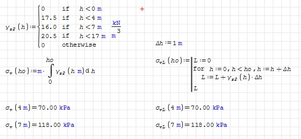

#4 Posted: 1/6/2022 3:04:40 PM
Hi. I think that this could be the solution.
TESTE TENSAO ADM MATRIZ.sm (5.88 KiB) downloaded 1168 time(s).
#5 Posted: 1/6/2022 4:49:36 PM
WroteHi. I think that this could be the solution.
I still don't understand purpose of for() loops. (not in your solution, original question)
Removing for()'s and calculating directly won't change the result.
#6 Posted: 1/6/2022 7:06:33 PM
WroteWroteHi. I think that this could be the solution.
Hi overlord. I guess because using γ.s2(h)*h isn't correct, there the correct acumulation is γ.s2(h)*Δh
TESTE TENSAO ADM MATRIZ.sm (10.8 KiB) downloaded 1138 time(s).

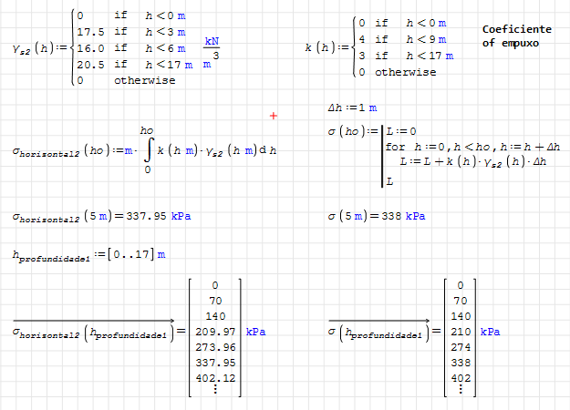

#7 Posted: 1/7/2022 8:51:39 AM
#8 Posted: 1/7/2022 11:23:15 AM

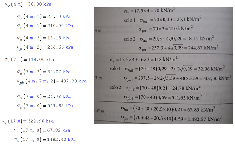

WroteWrotethank you all for making your time available, helping me with this problem but some of the solutions posted here do not match the values must be equal to sigma,v in the image or 70 kN/m2 at 4m depth and 118 kN/m2 at 7m depth.
At this point, up to You to handle the project.
I understood nothing in that big image.
TESTE TENSAO ADM MATRIZ (in_situ parametric).sm (18.6 KiB) downloaded 1213 time(s).
PERFECT FELL LIKE A GLOVE is there a way to rotate the result of the graph 90 degrees?

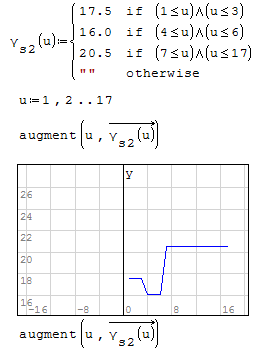

#9 Posted: 1/7/2022 4:01:35 PM
#10 Posted: 1/7/2022 5:44:30 PM
This is a way to do that in SMath.
TESTE TENSAO ADM MATRIZ v2.sm (455.7 KiB) downloaded 1281 time(s).

#13 Posted: 1/8/2022 4:45:12 PM
Wrote(don't download this)
Offered as demanded in two separate parts in same document.
Thank you all for making your time available, helping me with this problem but some of the solutions posted here do not match the values must be equal to sigma,v in the image or 70 kN/m2 at 4m depth and 118 kN/m2 at 7m depth.
see the resolution of the problem in the attached image
Project Algo_Parameters Copy.sm (663.42 KiB) downloaded 1181 time(s).
