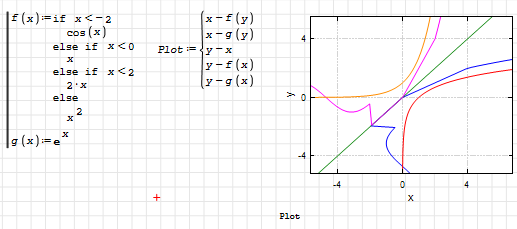

Hey guys,

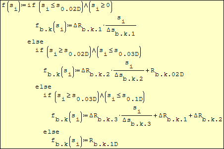

im trying to plot my function with x-yplot (addon) but it doesnt work. I will be happy if can someone can help me.
i define two functions (with If-clauses) and now I have to put it in x-y-plot.
Thanks for helping

#2 Posted: 2/11/2023 9:51:05 AM
I define two functions (with If-clauses) and now I have to put it in x-y-plot.
1. Start by the first red instance ... assign the demand.
2. For the plot Units don't match
3. Check if your incomplete Bolean is OK ... here shown complete.
4. What is mPa
#3 Posted: 2/11/2023 11:27:05 AM
598 likes in 1,380 posts.
If you want to plot, you have to eliminate units.
Either by writing a unitless function, or using units while plotting.
I would rather second one.
Pfahlsetzungslinie.sm (112.67 KiB) downloaded 1324 time(s).

hey guys thanks. (i tryed to give you a thanks but i always get an error)
it works now. Ive realized my mistakes.

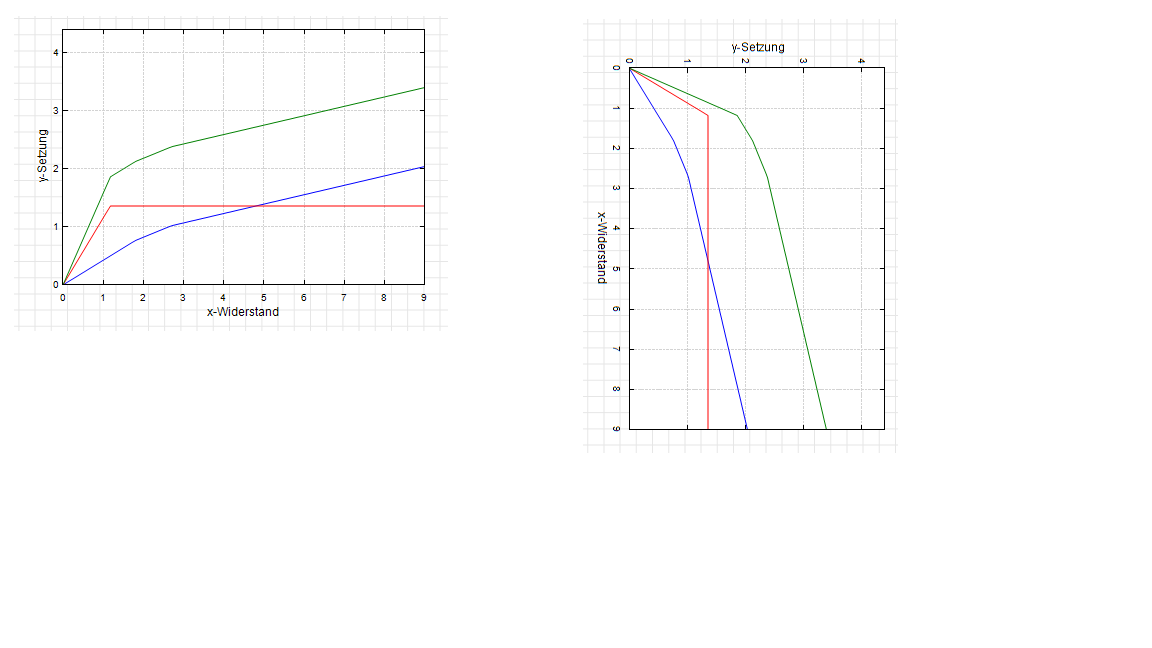

i have 2 more question.
1. is it possible to rotate the graph or function? I wanna switch x and y axis
2. i wanna make the visible spectrum of x and y axis depent on a variable. like X-Axis Max=s1 and Min=s2
//sorry for my bad english

#8 Posted: 2/12/2023 1:43:27 AM
... i have 2 more question.
Hi Beyaz.

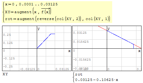

1. Yes. For example you can use this technique over your functions
xy-yx-plot.sm (7.16 KiB) downloaded 1257 time(s).

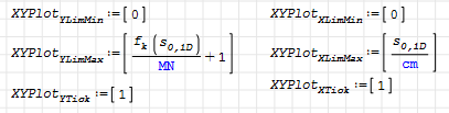

2. Yes. For example you can try to learn about how to use setprop in an XY plot region.

question 2: solved after find this
https://en.smath.com/forum/yaf_postsm57205_X-Y-Plot-Region.aspx

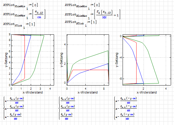

but to rotate the graph like this it didnt work. i tried your suggestions. Pfahlsetzungslinie1.sm (80.01 KiB) downloaded 1279 time(s).
#10 Posted: 2/12/2023 8:47:18 AM
Hi. You need to specify the XYPlot index. This is how to swap axis coordinates, and reverse the y-axis. I reduce the number of points in the XYPlot to 50.
Pfahlsetzungslinie1.sm (87.42 KiB) downloaded 1299 time(s).

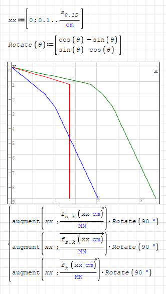

You can also use a rotation matrix.
It works on both 2DPlot an XYplot.
churichuro 2/13/2023 4:11:00 PM
#14 Posted: 2/13/2023 10:41:33 AM
Rotate XY.sm (486.01 KiB) downloaded 1288 time(s).
