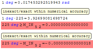

Dear all,
In a cam profile generation program, I perform some boolean operations with angular values (input in degrees).
I noticed some boolean operations fail due to a varying accuracy.
The file in attachment will clarify what I mean.
How can I make these values equal? Reduce the amount of significant numbers?
Thanks in advance for any feedback!

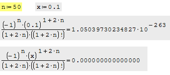

... differently puzzling: set n 49, 50

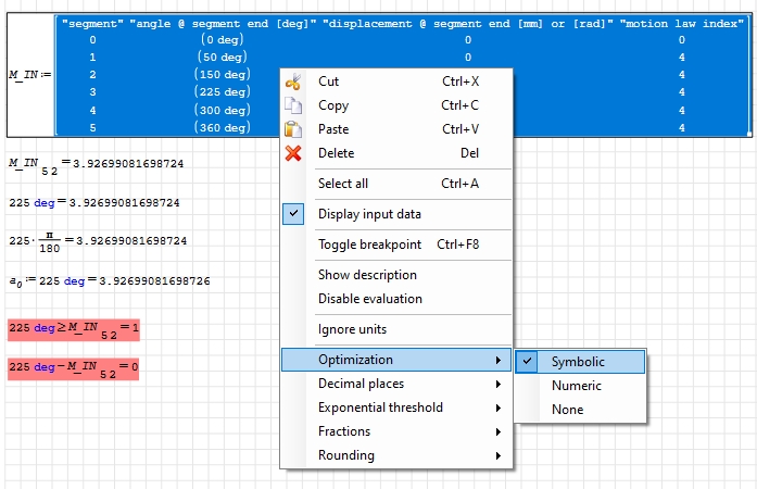

#4 Posted: 5/12/2022 6:30:06 PM
...Accuracy.sm (7.11 KiB) downloaded 1597 time(s).
Choose symbolic optimization in the matrix definition.

#5 Posted: 5/13/2022 9:44:14 AM
How can I make these values equal ?
Leave the main matrix numeric, explore Numeric/Symbolic in-situ
The two Boleans disagree ... IMHO, Numeric is the practical procedure.
Cheers ... Jean.
