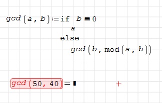

I'm not sure, but I think I might have found a bug:
I remember this used to work before. Am I doing something wrong?

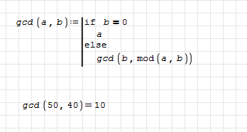

error
You need to use line operator in function definition.

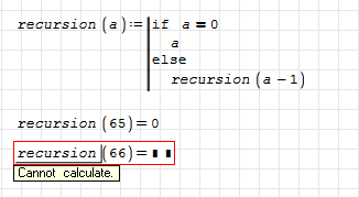

Example of recursion limit.

Hi. Every CAS should have a recursion limit. The point would be to be able to control it, like in Mathematica: https://reference.wolfram.com/language/ref/$RecursionLimit.html

Thanks!! How did I forget that. heh.

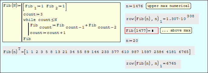

The Mathematica 4.0 Fibonacci recursion has Smath companion algo style.

That is not an example of recursion, that is an iterative method. Try googling something like "iterative vs recursive Fibonacci".

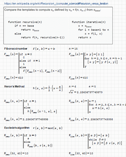

Either.
recursive_versus_iterative.sm (40.78 KiB) downloaded 1550 time(s).
