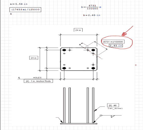

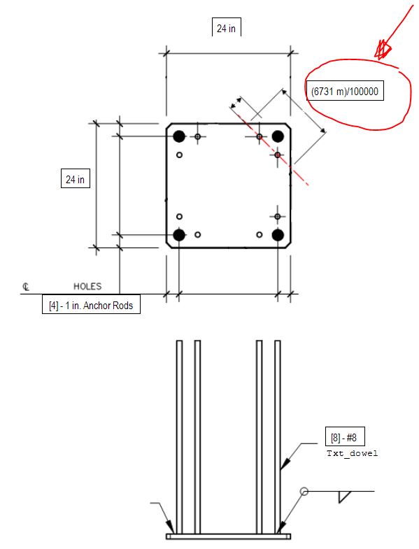

I am trying to display output calculations visually on a diagram in SMath through text. whenever there is decimal/fraction it always displays it in fraction format and I want to display it in decimal.
how can I do this please knowing that I already tried forcing the "fraction" option in the Tools to "Decimal"?

Thanks Jean, but I did not understand how you made it work.
Can you send a small example?

#5 Posted: 10/10/2017 8:22:29 PM
If you are using the conditionally formatted label or a plot, it is possible to use var2str() from CustomFunctions plugin.
Otherwise you can simply use a math region, right click on it and uncheck "Display input data", add a border (if you want), and that's all (in this case, use the options that Jean has mentioned in his first reply)
example.sm (8.79 KiB) downloaded 1228 time(s).

#10 Posted: 10/11/2017 1:03:00 PM
I think is better to use the result directly in the drawing by changing the units and hiding the name of the variable
example_IMD.sm (546.71 KiB) downloaded 1236 time(s).
