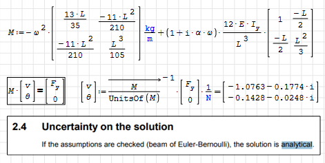

I'd like to solve the following equation involving matrices for unknown v and θ:
After inputting it in the format used by the Maxima plug-in I get the "no result" message:
Am I doing something wrong ?

I think the problem is that the units don't match. Compare the units of the components of the two terms inside the brackets that multiply the [v; theta] vector.

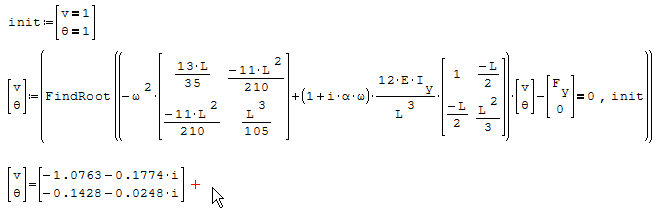

FindRoots ignores Units. Code the image first.

Thank you, I didn't know that I should use the Nonlinear Solvers plug-in instead of the Maxima one.
It works now but the result is surprising. It should be something like v = - 0.021020 for the real part with this input data.
I also suspected the units initially but it didn't work without them either.

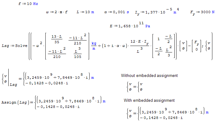

Besides correction of the unit mismatch, Solve seems to want the matrix equation in homogeneous form.
