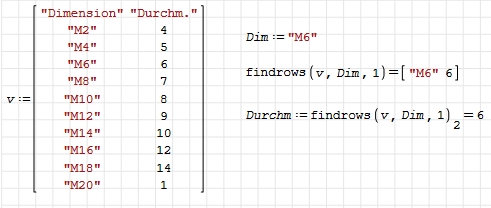

#2 Posted: 9/1/2021 3:05:01 PM
Hi. You have findrows in SMath
Stefan Müller 9/1/2021 3:08:00 PM

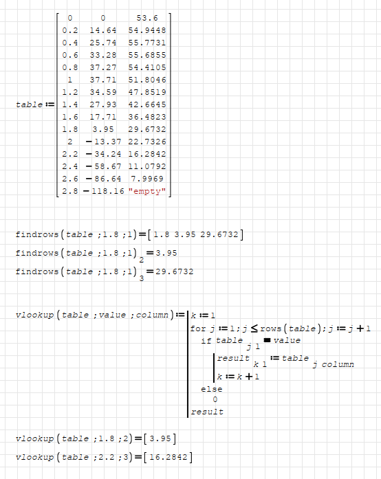

#4 Posted: 9/1/2021 3:19:23 PM
598 likes in 1,380 posts.
You can either use findrows() as Razonar mentioned.
Or you can use custom written vlookup() function uploaded before.
But I would stick with findrows() if I had to choose.
Worksheet1.sm (8.43 KiB) downloaded 1153 time(s).
