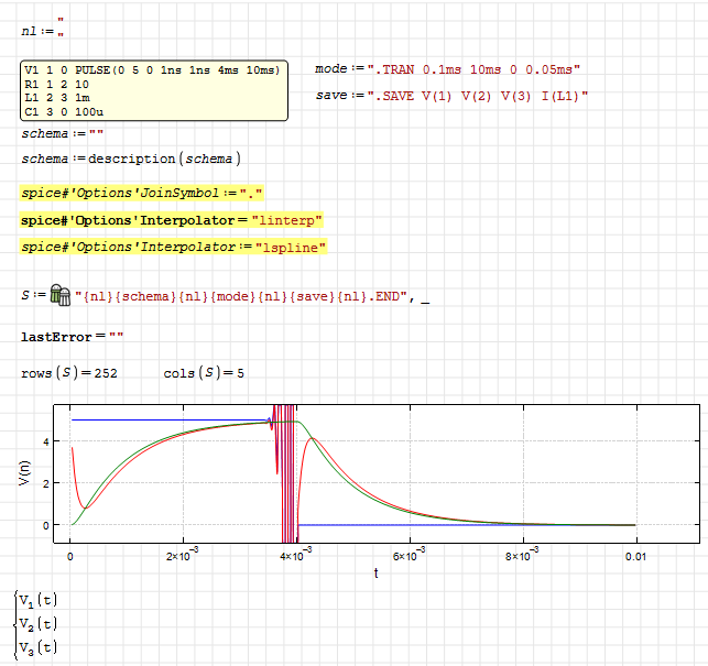

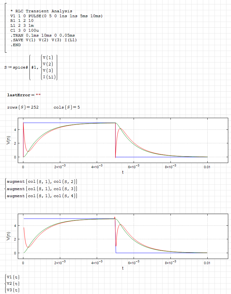

Plugin updated. [BETA]
Changes:
- expanded capabilities of spice#() function.

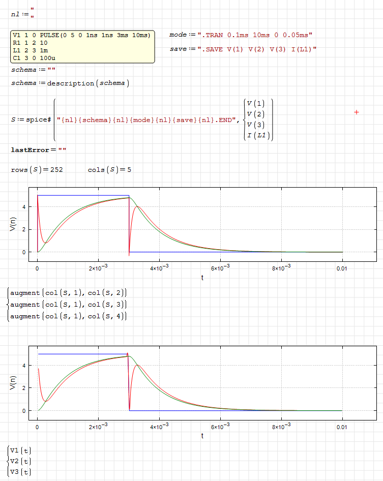

spice#-tran-example01.sm (10.7 KiB) downloaded 1216 time(s).

#12 Posted: 9/11/2025 3:34:13 PM
1,555 likes in 1,867 posts.
spice#-tran-example02.sm (11.84 KiB) downloaded 1212 time(s).

- Custom Icon/Glyph Rendering
- Automatic Export from .SAVE Statement.
- Automatic Interpolation Function Generation.
spice#-tran-example03.sm (11.78 KiB) downloaded 1235 time(s).

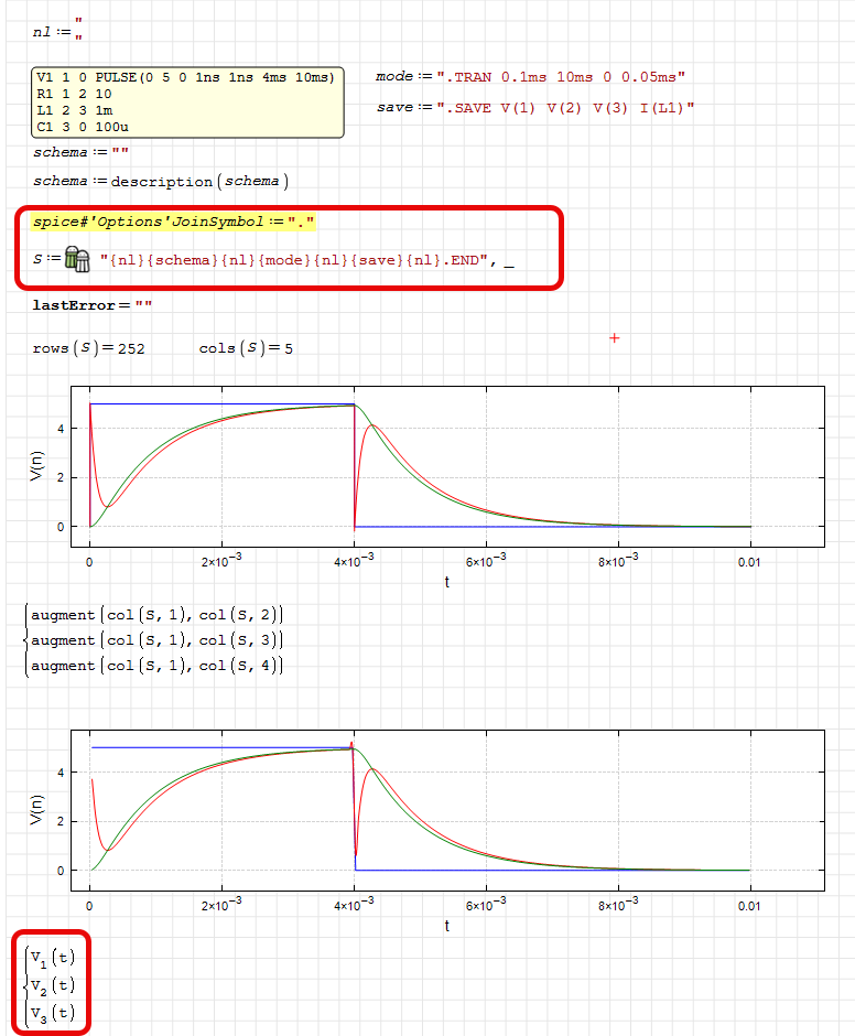

Changes:
- Refined Glyph Rendering;
- Added "spice#'Options'Interpolator" Operand.
Edited 9/12/2025 5:05:27 PM
#15 Posted: 9/12/2025 11:10:39 AM
It works
Alvaro 9/12/2025 6:01:36 PM

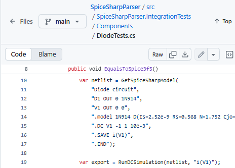

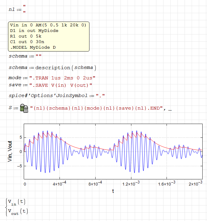

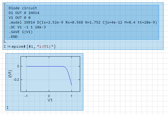

Hi Viacheslav. Great work, congratulations. Some questions:
I was able to introduce an ampop, which is a fairly theoretical model without many physical parameters. How did you introduce the diode model?
Is it possible to import ltspice models more or less automatically?
Another question: how could V1, V2, and V3 be graphed in your 3DPlot plugin? The CreateSpace function is new, isn't it? Do you have examples of how to use it? Generally, these graphs can't be created in simulators, and the data must be exported to MATLAB or other similar software.
I can tell you how to proceed, i.e. the algorithm for setting the problem.
If you want to simulate the scheme, then you need an example. Nowadays, in the programming world, it is common to accompany source texts with tests. These tests, as a rule, cover many typical tasks.
You need to find these texts, see the link below. Then introduce Gemini to the matter so that he can help create an adequate syntax. I simply throw the test sources into the chat as an example and say what I need.

Links:
1. SpiceSharpParser.IntegrationTests
Alvaro 9/12/2025 7:45:30 PM
#18 Posted: 9/12/2025 7:56:21 PM
Hi Viacheslav. Thanks, the link you provide shows how to simulate components, for example, a diode:
One more question: An option to have outputs with units? I think it would just be a matter of identifying time, volts, and amperes. It would be very practical to be able to use milli, micro, and nano prefixes.
Edited 9/12/2025 8:03:32 PM
#19 Posted: 9/12/2025 8:27:17 PM
Quote
Good advice. We need to think bigger. I want to add elements from the sheet to the schema code. For now, this is done in a limited way, because there is not enough time to think of a convenient solution, but in general it will be possible to both set variables with units separately and get a response with units.
There is probably some support for this in the library code. I'll take a look.
