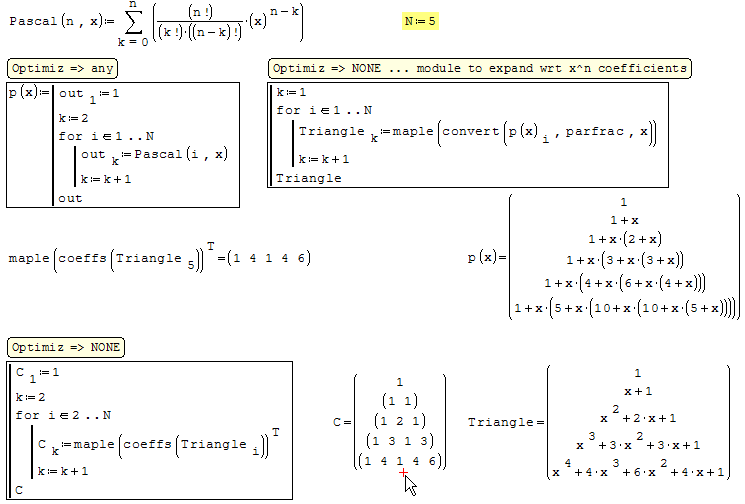

The expanded form is correct, coefficients as well but not in corect order.
I suspect Maple is koko ! I can do by hand for the project in cause.
Smath 5346 OFFicial release. I recall UNI mentioned some bugs in Maple ?
