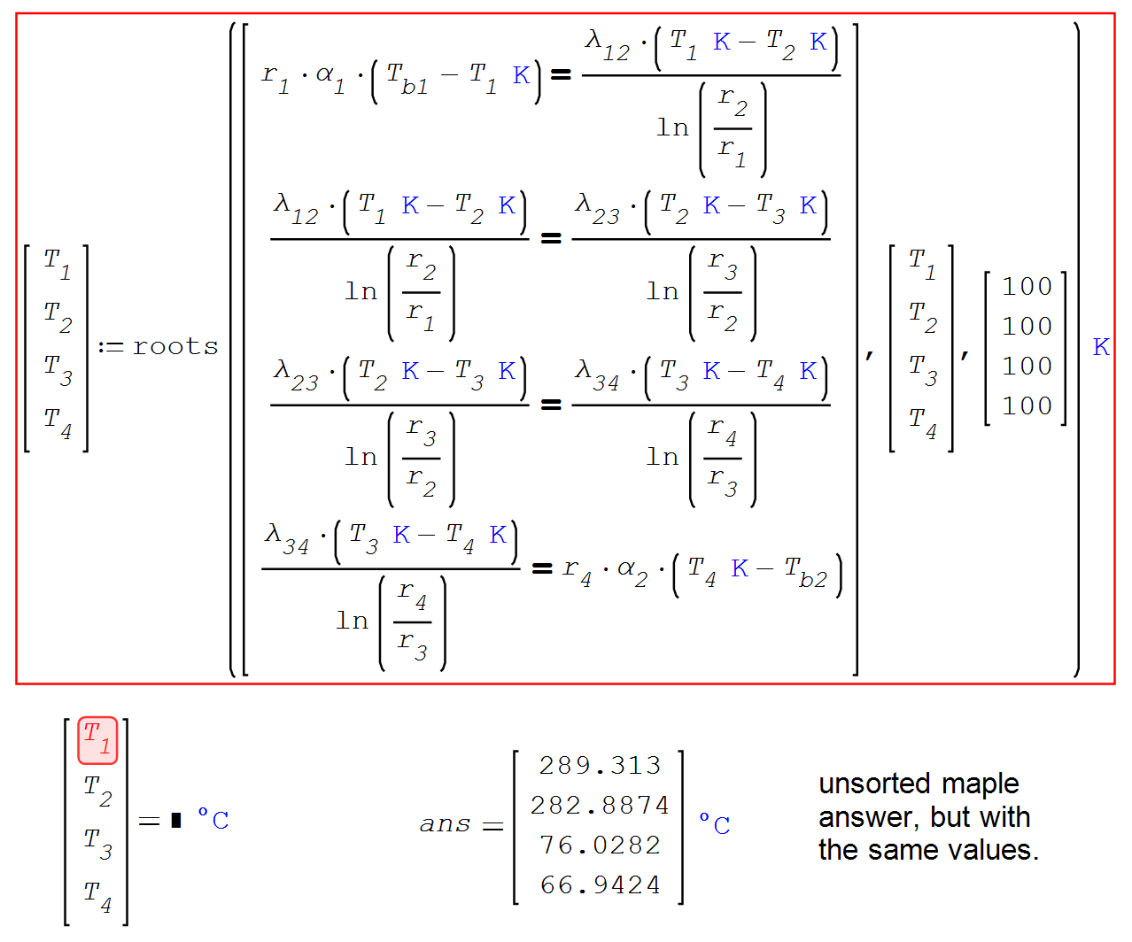

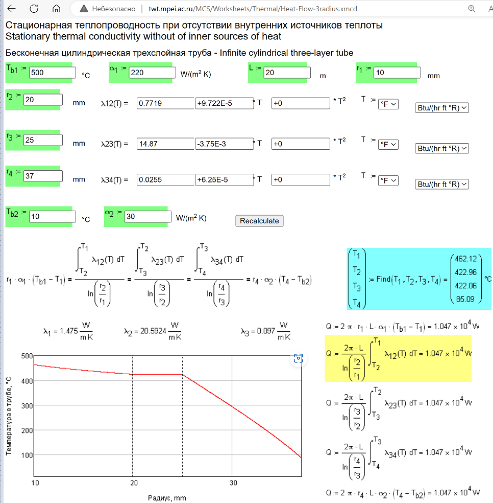

I would like to to sole the linear equations
F1=F2=f3=F4 with 4 unknowns T1, T2, T3 and T4
I can do it in Mathcad (given-find). but cannot in SMath ;-(
Help me please!
See please the Mathcad Calculation Server
http://twt.mpei.ac.ru/MCS/Worksheets/Thermal/Heat-Flow-3radius.xmcd
my SMath try in attach and
Lambda3.sm (434.36 KiB) downloaded 1512 time(s).
the picture
#2 Posted: 7/21/2024 2:53:47 PM
Hi. Here two options for solve the system.
Lambda3.sm (452.05 KiB) downloaded 1515 time(s).

I see Alvaro has beaten me to it, but here's my approach anyway.
Lambda3b.sm (470.18 KiB) downloaded 1566 time(s).

Thanks to all!
My solution in attach
Lambda3.sm (265.4 KiB) downloaded 1550 time(s).
