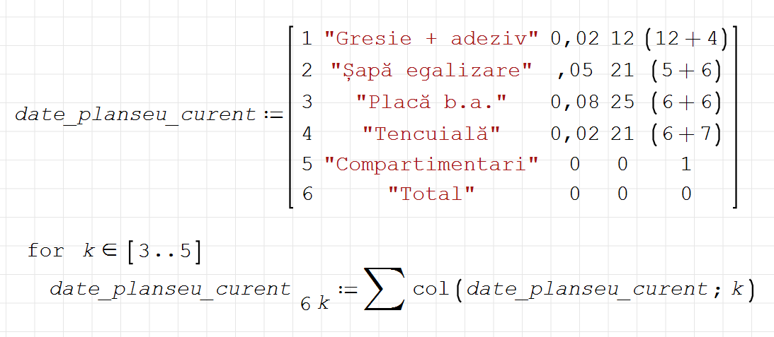

Hello guys,
I have a matrix with system of values in it. I want to sum up all the column.
Could you help me with this?

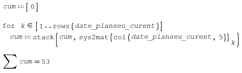

#2 Posted: 10/15/2023 5:33:50 PM
It's necessary convert each system of your 5th column to a matrix by sys2mat() function, then you can stack each matrix from 5th column and do the summation:

#3 Posted: 10/15/2023 6:01:59 PM
Hi Sergio,
Of course, Oscar’s proposal is a very interesting one
May I make a simple suggestion: avoid the use of “sys” data and replace it with a simple sum, as in my appended file.
Best Regards,
Ioan
If the column's sums are aasked, here is a solution for keeping the answer inside the box...:d
Best Regards,
Ioan
sumcomplexcolumn (1).sm (11 KiB) downloaded 72 time(s).
