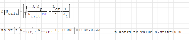

Hello everyone. I have a problem solving this equation. Could anyone help me? Thank You.
critical force.sm (8.82 KiB) downloaded 1335 time(s).
Hi lookmar,
use solve(4) instead of solve(2)
regards,
w3b5urf3r
