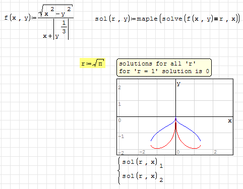

#7 Posted: 2/24/2017 3:11:27 PM
983 likes in 6866 posts.
Wolfram is of no help as you can check by yourself: it is ill posed.
"the limit of functions of two variables ..."
read: implict f(x,y) have solutions wrt 'x' or 'y' alternately.
Read the two Smath documents
Forum Implicit Limit.sm (12 KiB) downloaded 77 time(s).
Forum Implicit Wolfram.sm (4 KiB) downloaded 73 time(s).

#8 Posted: 2/24/2017 3:26:01 PM
this is just to know if it is possible from Smath using Maxima to handle limits of functions of 2 variables.
From the previous work sheets, answer is probably "NO"
Maxima will plot many implicit functions.
