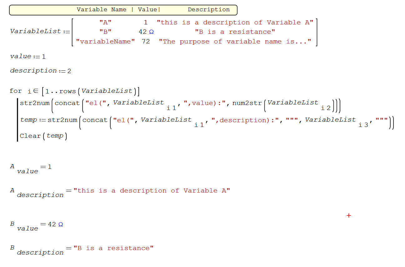

A matrix approach:
AssignValueAndDescription.sm (7 KiB) downloaded 62 time(s).
Arie 10/26/2022 9:59:00 AM, Alvaro Diaz Falconi 10/26/2022 2:26:00 PM

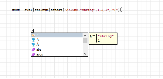

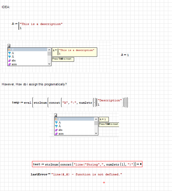

I had another idea using line function. But i'm not sure how to do it programatically... Any Ideas? Is it even possible?
Worksheet8_alternateIdea.sm (22 KiB) downloaded 56 time(s).

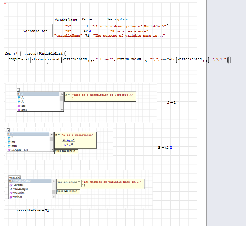

Aha! I figured it out
I'm pretty happy with this solution.
Here's my updated file for a reference:
⚜ Kenny Lemens, P.E. ᵂᴵ 10/26/2022 11:32:00 AM, Alvaro Diaz Falconi 10/26/2022 2:29:00 PM
