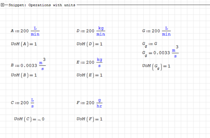

Hello
The unit operation snippet fails to detect units.
Snippet_Units_Fail.sm (33.04 KiB) downloaded 1567 time(s).

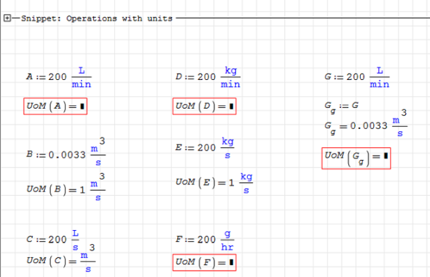

Try this
Snippet_Units_Fail.sm (32.38 KiB) downloaded 1496 time(s).

Thank you very much for your answer, but the snippet fails, since instead
of finding the units, it only obtains the value of 1

My bad, IDK why but yesterday seemed to work to me, but in fact it doesn't. I'll give another look at the snippet ASAP.

I see the issue. The function look for a numerator/denominator pattern in the num2str() text, but doesn't handle cases in which multiple divisions are involved.

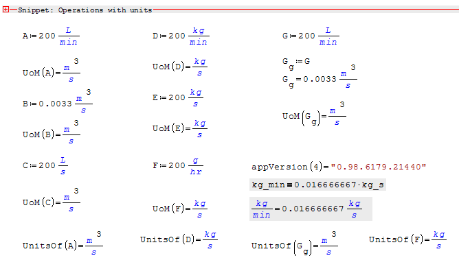

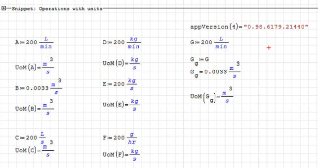

Thank you very much for your attention, I hope the Snippet has a fix-
On the other hand, I ran the snippet in version 6179,
and it works perfectly. How is that possible?
Carlos

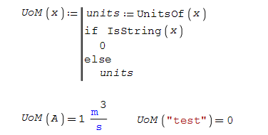

I'm not sure, however if you need a urgent fix here you have an easy way to make it working the same way.
