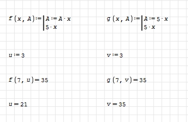

I am expecting the global variable value to change and maintain the change after exiting the function.
Example

Hi. The only way I know for a function to modify a variable is to pass it by reference to the function.

Hi.
example_by_ref.sm (4.86 KiB) downloaded 1174 time(s).

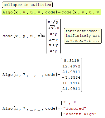

Native Smath has the exceptional feature of being algo style.
You can do what you want from in-situ command line.
