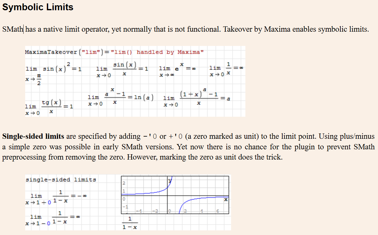

The Maxima plugin can handle limits symbolically. Below you find a preview of the SMath with Maxima handbook, it is to appear with the next release of the Maxima plugin. Ordinary limits work in the current version. Single sided limits will be part of the next release.

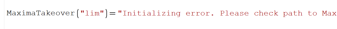

But I have
Send please the SMath-file

Do you have maxima installed?

Instructions for installation
Install.pdf (155.27 KiB) downloaded 1164 time(s).

There is a limit function Razonar provided sometime ago.
It is a native SMath function, so it won't need anything installed.
If it suits, you can use that too.
https://en.smath.com/forum/yaf_postst20355_Limits.aspx
