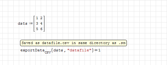

You can use the data exchange plugin. To install go to Tools->Plugins... -> Click (Local Storage) and select Online Gallery -> Look for "Data Exchange" -> Double Click to install.
A simple example of exporting to CSV is shown below. Note: you will need to save the .sm before exportData function will work.

It still does not seem to work for me. I installed the Data Exchange Plugin and used the following syntax.

Thanks again. I discovered my issue. The = is a symbolic evaluation.

WroteThe = is a symbolic evaluation.
Not quite so ... =1 is logical answer "yes saved"
