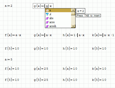

    #12 Posted: 10/1/2012 7:05:48 AM
    adiaz
    adiaz
    5 likes in 25 posts.
    This is not the error, but some interesting way to work with functions. In other words it is like one more option of Optimization. Numeric optimization means, that program will try to evaluate right part of equation numerically, symbolic optimization - evaluate symbolically, no optimization means, that program will substitute all previous definitions to the right part of equation and line(..) function at right means that program will not substitute previous definitions to the right part at all.
    I'm not comftable with this. As shown in the picture, when write 'g', 'a' appears as 'a = 2'. Others programs have a warning message for the use of global variables locally. I think that you must to introduce a global command to catch the value of a in g(x).
    Regards.

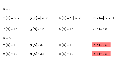

    #13 Posted: 10/1/2012 9:15:31 AM
    325 likes in 2052 posts.
    Hello Alvaro,
    I could not get the same results as you did.
    See the picture please.
    #14 Posted: 10/1/2012 9:44:55 AM
    adiaz
    adiaz
    Hi. In my example it is (|a*x)*1, but yours is (|a*x*1)
    Regards.
    #15 Posted: 10/1/2012 10:03:28 AM
    Hello Alvaro,
    You are right. This might be sometimes quite frustrating. Everything looks the same but the result is different. SMath can not deal with braces correctly and satisfactory quite often
    This one is one of the examples of that problem I mentioned few times here on the Forum.

    #16 Posted: 10/1/2012 11:05:07 AM
    adiaz
    adiaz
    Well, as I see, this the price for obtain clarity in others expression. Mathematica have a lot of this problems with TraditionalNotation, Maple too. But at the end, this give less mistakes that working with parenthesis and text notations.
    Defining a function as f(x) := 1*(| ... ) make all variables in line(...) as globals.
    Regards.
