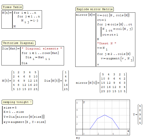

#6 Posted: 6/1/2016 9:13:53 AM
How could I get a vector from a diagonal?
Like this ?
Utilities Matrix [Times, Dia, Mirror,Euclid].sm (39.12 KiB) downloaded 1078 time(s).

#7 Posted: 6/2/2016 1:55:15 PM
experimentator
experimentator
1 likes in 21 posts.
Like this ?
Thank you.
