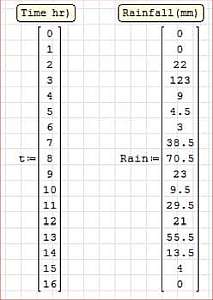

It will be much appreciated if somebody can show me how to draw a bar graph in X-Y Plot or ZedGraph,
using two vectors as shown please ("t" in x axis, "Rain" in y axis).

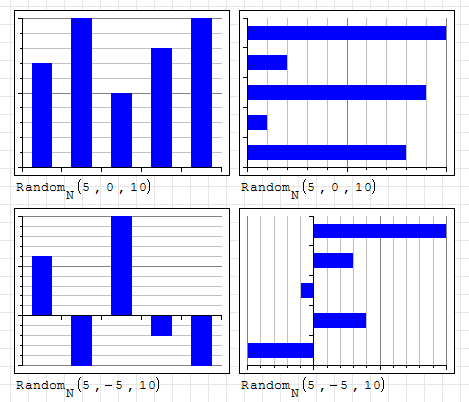

#3 Posted: 11/7/2016 3:51:00 PM
Just in case, might worth the effort to try with the modeller region
As far as I know there are no bar graphs in SMath.
True
Show Spoiler
NDTM Amarasekera 11/7/2016 10:51:00 PM, Radovan Omorjan 11/7/2016 4:28:00 PM

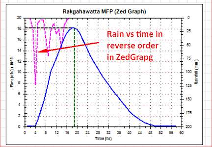

To demonstrate a Flood Hydrograph, it was only possible to draw a line graph (in reverse order) in ZedGraph.
In X-Y Plot reverse order is not possible.

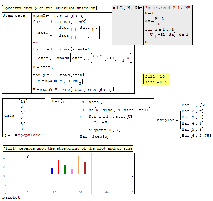

#7 Posted: 11/8/2016 12:23:45 AM

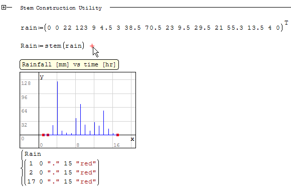

I know nothing about "Zedgraph".
I can se Davide had a "cat in the hat".
Stem plot does same/different in no time
except for the red 0 rain [<20 sec]
Cheers, Jean
Forum Rainfall.sm (87.7 KiB) downloaded 1250 time(s).

#8 Posted: 11/8/2016 2:47:45 AM
This scrap proposal makes me happy for some
distinctive small project. Manual but convenient
for small projects. For larger size and unicolor
the project needs be constructed around a counter.

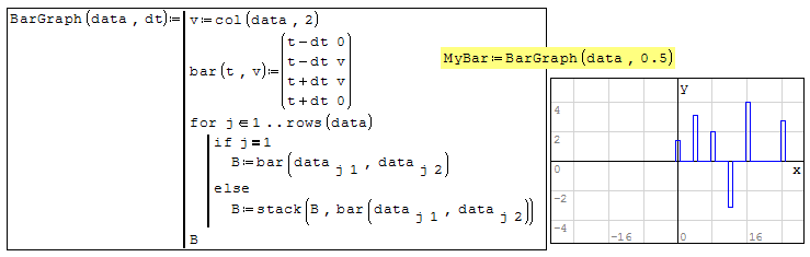

#11 Posted: 11/8/2016 7:12:41 AM
1,555 likes in 1,867 posts.
Simple example
Radovan Omorjan 11/8/2016 7:29:00 AM, frapuano 11/8/2016 8:06:00 AM

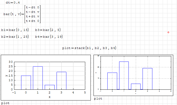

#13 Posted: 11/8/2016 10:38:56 AM
#14 Posted: 11/8/2016 11:07:35 AM

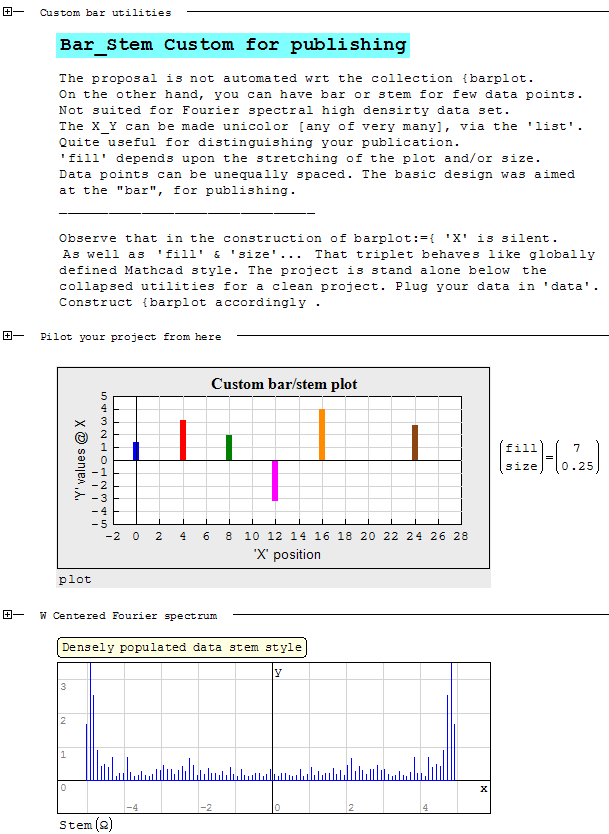

In the Viacheslav proposal, you don't see bar not plotting equally wide.
Because the bars are so wide ! In the real project I proposed, the bars
are much thiner for dense project. Thus there will always be at least
"one" bar looking thiner because of the plot pixel impossible to match
perfectly along the stretching of the plot.
Cheers, Jean

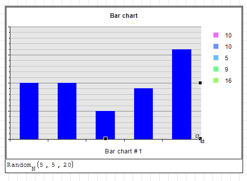

#15 Posted: 11/9/2016 7:26:03 AM
NDTM Amarasekera
NDTM Amarasekera
130 likes in 352 posts.
Simple example
I used method proposed by Uni to plot Bar Graph to show rainfall in ZedGraph as shown (in reverse order).

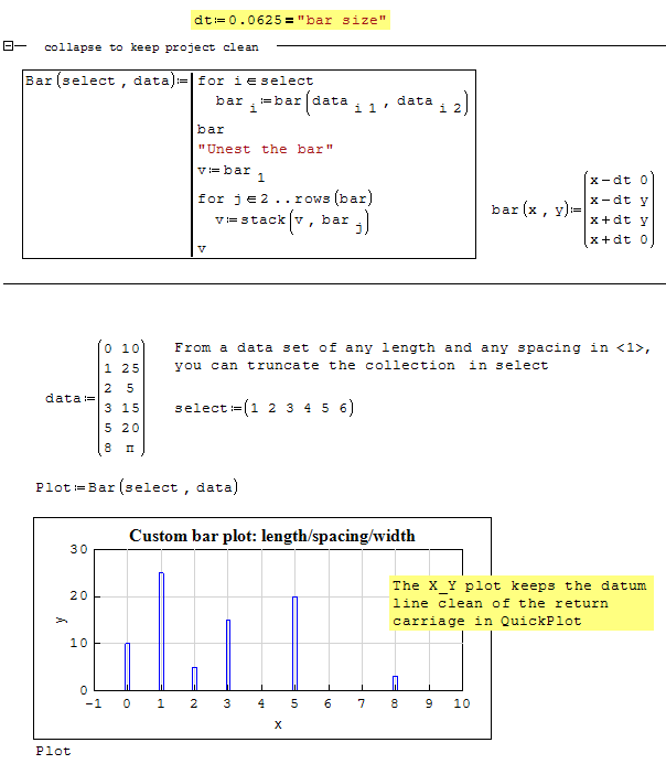

#16 Posted: 11/9/2016 11:54:21 AM
Thanks for the "Zed Graph" snippet. I don't have this plugin
whereas I will stay Smath 5346, and don't intend to upgrade.
The attached document is for publising projects.
Cheers, Jean
2D Bar Plot Custom.sm (35.01 KiB) downloaded 1232 time(s).
