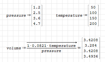

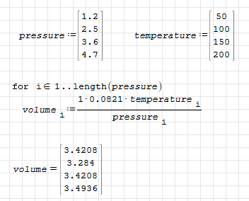

#6 Posted: 11/16/2017 3:01:37 PM
Here you have:
The arrow over the math is the function vectorize(), and that's what you need to apply the elements of the ranges avoiding loops (that is the other way to accomplish the task)
