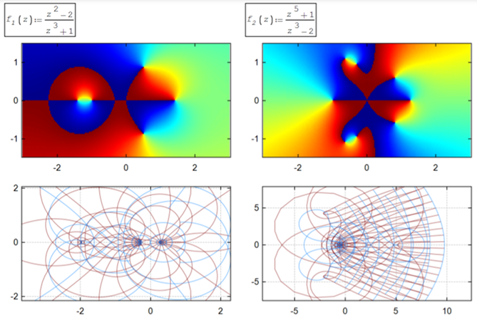

Hi. The attached shows how to plot complex functions plotting a colormap of it's argument, and how to interpret that plot.

And the more classical complex map.

Both toghether with an improved complex map. But the previous reamins because can be useful for simple functions, as it is faster ( For compare can be seen https://www.wolframalpha.com/input/?i=complex+map+ln%28z%29 )
