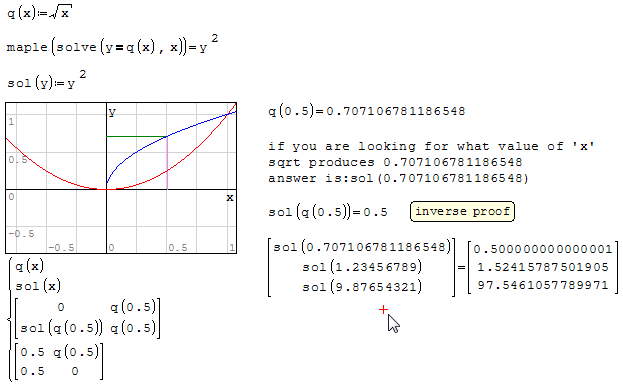

I have a function (for example y = sqrt(x)).
I want to solve it for specific values of x between x
You don't have to solve between limits,
whereas you are solving generally.
No problem to constrain the plot [not shown].
Your question is ill posed, as I can figure.
Solve Inverse Symbolic Suite.sm (93 KiB) downloaded 59 time(s).

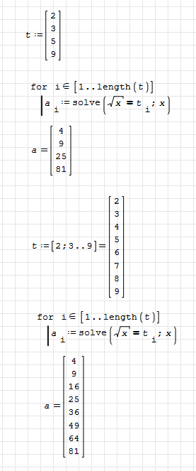

are you looking for something like this?
you can use matrices or vectors and loops.
don't forget to change your roots range in the tools>options>calculation menu.
#4 Posted: 9/22/2019 3:52:07 PM
983 likes in 6866 posts.
Harry Mangurian 9/22/2019 6:08:00 PM

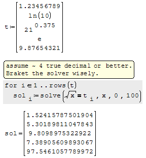

#5 Posted: 9/22/2019 3:56:52 PM
Solve SQRT(x).sm (9 KiB) downloaded 76 time(s).
