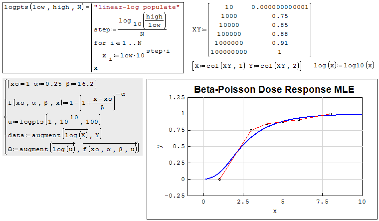

#1 Posted: 12/3/2019 10:12:53 AM
... else than Bode.
Utilities logpts [Beta_Poisson].sm (9.4 KiB) downloaded 991 time(s).
#2 Posted: 12/3/2019 12:21:29 PM
... else than Bode.
... more USER
Utilities logpts [Beta_Poisson].sm (13.52 KiB) downloaded 983 time(s).

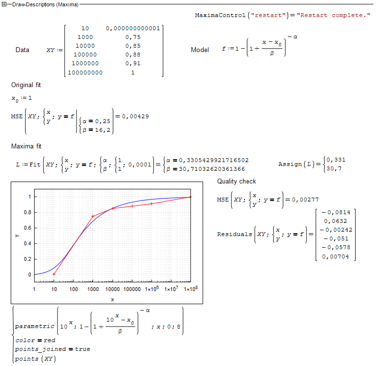

#3 Posted: 12/3/2019 3:02:11 PM
Here is a Maxima version, including the fit procedure. Note the use of parametric() in order to get evenly distributed points in the log plot.
logplot.sm (145.83 KiB) downloaded 1262 time(s).
frapuano 12/3/2019 4:52:00 PM, NDTM Amarasekera 12/4/2019 1:06:00 AM
#4 Posted: 12/3/2019 10:19:59 PM
Thanks Martin.
1. added the source experiment notes
2. added Weibull MLE example.
Utilities logpts [Beta_Poisson].sm (353.86 KiB) downloaded 1114 time(s).
