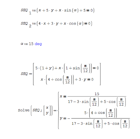

How to turn of the decimal values in trygonometry angles value? I got sth lik this for solution of system of equations:
The file with example: example_v1.sm (8 KiB) downloaded 1104 time(s).
A.

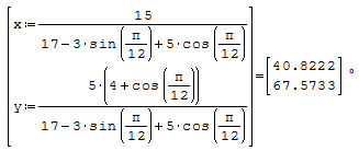

You can use the function al_nlegsolve with any initial
assumptions (because the equations are linear)
al_nlegsolve.sm (11.18 KiB) downloaded 1108 time(s).

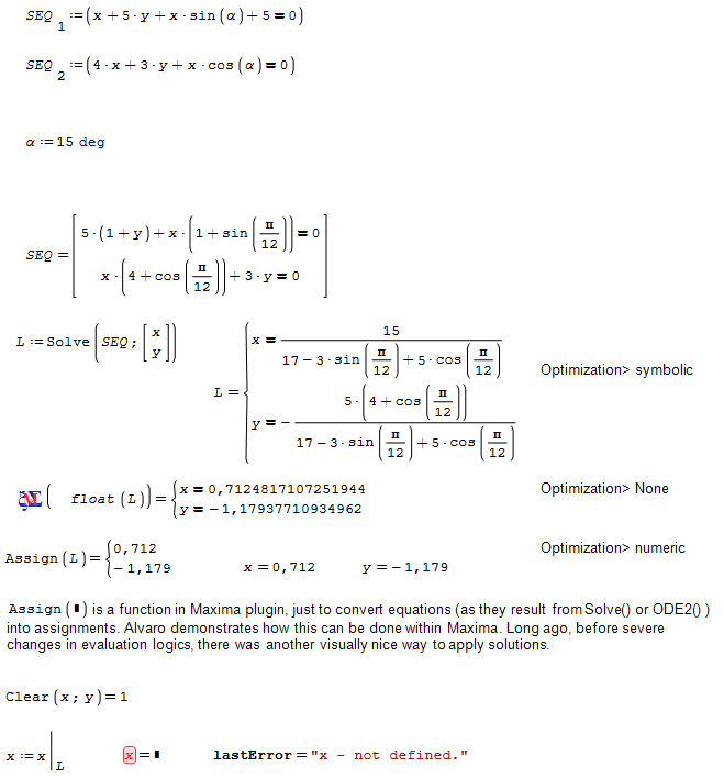

#3 Posted: 9/9/2021 9:52:40 AM
How to turn of the decimal values in trigonometry angles value ?
By default, trig are in decimal radian in all CAS.
Recast your solutions, fill-in the unit place holder.

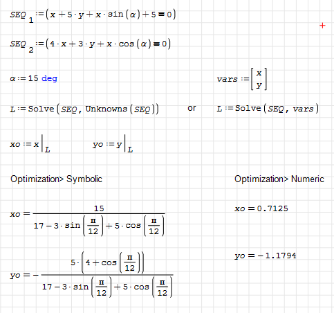

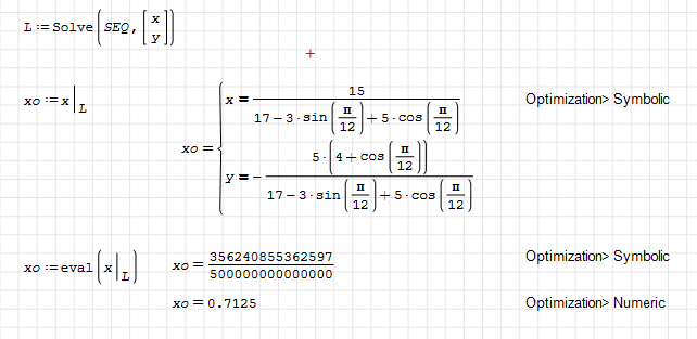

#4 Posted: 9/9/2021 11:20:45 PM
Hi. You also can use Maxima commands, in this case ev():
#5 Posted: 9/10/2021 5:37:18 AM
example_v1.sm (13.63 KiB) downloaded 1129 time(s).
sergio 9/10/2021 6:11:00 AM

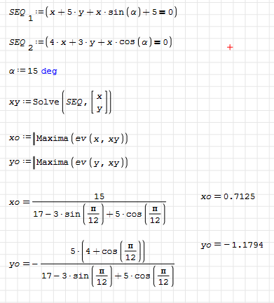

#6 Posted: 9/10/2021 1:02:39 PM
Hi Martin. I use Maxima's ev() because SMath's Assign() only works with the variable names, instead others, like xo, yo, and SMath's at() doesn't works for the symbolic evaluation, as shown this picture:
example_v1.sm (15.95 KiB) downloaded 1108 time(s).
This is a workaround for use only SMath native functions or plugins, without any explicit Maxima function:
example_v2.sm (15.16 KiB) downloaded 1172 time(s).
