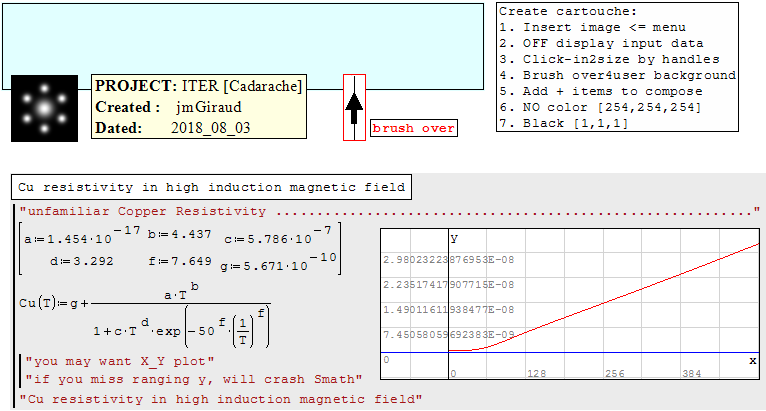

Easy to compose your own Company Cartouche [Smath 6179].
Once all composite items are done, slide inside in the image region.
Before adding your particular project, save your Cartouche as model
template [an ordinary Smath document].
If you just want plain text for the project items and no grid,
set the background [254,254,254]. Not exactly white but clear enough.
At this point... as you "Save as", you will get an error message
Can not find file
No picture saved
Click OK caption, Smath saves in its own way as an ordinary document.
Comments/suggestions: welcome ... Cheers, Jean
