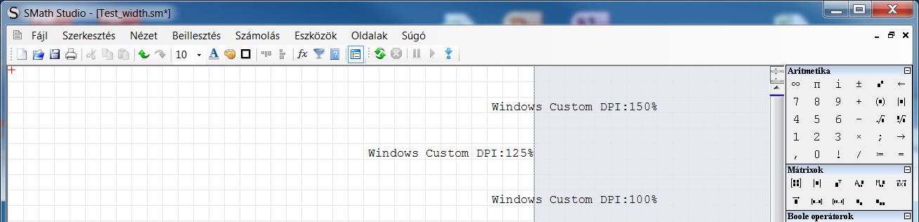

I've found an issue in SMath.
I made more SMath document with 100% Windows Custom DPI. Month ago I changed my monitor and I had to change Windows Custom DPI to 125%. Unfortunatelly I can't now print my old documents, because the right side of the documents located on the nonprintable area yet.
I use Windows7, I tested 100%, 125% and 150%.
This screenshot was created with 125% Windows Custom DPI:
Here is a test document:
Test_width.sm (1 KiB) downloaded 89 time(s).
There is an other small issue too. I have to click two times to Print icon in printer selection page if I would like to print. First time nothing happens.

2273 likes in 3737 posts.
Hello Peter.
Yes, I'm already informed about this issue. Working on it right now.
Sorry for inconvenience.

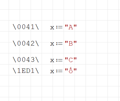

I have a problem with strings in smath worksheet. It turns out that some characters are converted if input string matches some hexadecimal characters..i don't know if this is a feature..but it transforms some of my smath documents specially with strings as FilePaths..please see attached snapshot.
