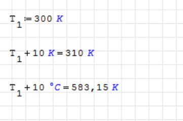

Hi
When I do the following, the results are not correct:
Here is the file I used:

You must use the unit of measurement for temperature differences
[albumimg]1387[/albumimg]

I understand now what is happening: 300K + 10C -> 300K + 283.15K = 583.15K

300K 10C -
_______________________________________
Your understanding is correct: the unit of temperature is °K.
Working with unit means consistant system, particularly true
working trig functions.
That freeware "Uconeer 2.4" from Katmar is most precious.
Some smart decided the triple point of water that was 0 °C
is now 0.01°C
