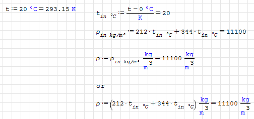

It is essential to distinguish variables representing actual physical quantities (number times unit) and just numbers.
It is very common in engineering, that equations are given not as physical equations (which strictly use quantities) but as a package of numerical formula plus specification of what units are to be used in order to generate the input numbers (I refuse to say input quantities) and what unit has to be given to the output number in order to get the result quantity.
Usually, you can do that in a transparent way by just dividing the input quantities by the specified unit and multiplying the output by the desired unit. In the case of temperatures it is more involved, because of the gauge offset. Then you can use an explicit conversion or a conversion function.
If a symbol's value is only meaningful when interpreted using a particular unit, then the name should reflect this fact.
![2018-02-27 09_58_44-SMath Studio - [tinc.sm].png](/en-US/files/Download/8PhFKr/2018-02-27-09_58_44-SMath-Studio---[tinc.sm].png)
tinc.sm (5.53 KiB) downloaded 1168 time(s).

#3 Posted: 2/27/2018 6:38:58 AM
I would operate in the way illustrated. However, there are problems with the use of degrees Celsius
[albumimg]1470[/albumimg]
#4 Posted: 2/27/2018 7:05:23 AM
@mkraska: Thx, that did the trick.
@PompelmoTell: I was trying to do something like that but also had problems with °C because K is default unit. Thx anyway.
