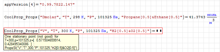

I am using smath version 0.99 build 7822
and coolprop plugin 6.1.7713.14622
and I have the error in the image, you can view it at this address "https://i.postimg.cc/pVKhFJDK/Immagine.png"
how can I solve it?
Thanks in advance.

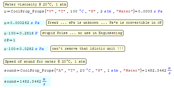

From design or else wrongdoing the built-in unit system should
be evaporated to avoid idiotic results.
I Consulted for years with my Ti-58/59 w/o units.
Inst_Viscosity Water.sm (43.72 KiB) downloaded 1431 time(s).

That stuff is Viacheslav baby.
Authors: Davide Carpi and Mike Kaganski.
Plugin updated, but now the error is different:

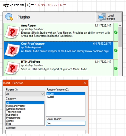

Hi Viacheslav. After a clean SMath installation, coolprop don't appear as defined function. My windows is 32 bit, do you have where to check that?
Thanks in advance.
#9 Posted: 7/5/2021 1:30:30 AM
1,555 likes in 1,867 posts.
It's true, functions are not loaded. I have tested the plugin with local build. Something goes wrong when building on the server. I asked Andrey about it.

I thought the "not loading" functions are an issue for linux.
And I thought plugin is written maybe only for windows.
So error was general then.
