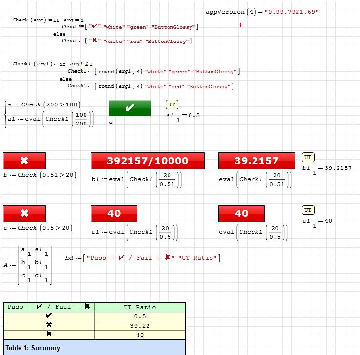

I have been playing with the buttons and have found a possible bug when assigning a variable to the input data, see the image below and the second red button, compared to the third red button:
more buttons.sm (18 KiB) downloaded 70 time(s).
Is this a real bug?

Is this a real bug?
Thanks
Hi. I don't know if it is, but looks like a real bug. BTW this is a workaround
