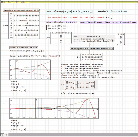

There is a bit longer story behind "HyperSine".
For another time when I will publish the "0Appendix"
Genfit Fit Hypersine.sm (28.8 KiB) downloaded 1443 time(s).

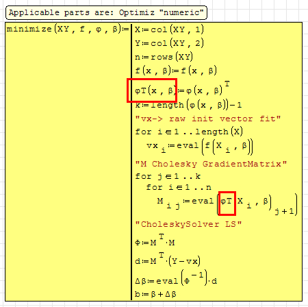

Using trace() seems that transpose() now holds a symbolic expression if applied in the form f(...):transpose(f(...))); this makes impossible to obtain a numeric result for length() and then proceed in computation of stuff related to k inside minimize; according to Andrey's comments of SS-2335 I suppose is one of the different behaviors of functions able to handle undefined data (like transpose).
You have 2 solutions in current 0.98:
![2016-07-01 01_47_27-SMath Studio Desktop - [Genfit%20Fit%20Hypersine.sm_].png](/en-US/files/Download/3aSe6e/2016-07-01-01_47_27-SMath-Studio-Desktop---[Genfit%20Fit%20Hypersine.sm_].png)
- in this case you can simply remove the row φ(x,β):transpose(φ(x,β));
φ(x,β) is a vector and for calculations inside Jean's minimize() there aren't reasons to have it transposed, since linear indexing is used inside these loops); - a more general solution (f.e. if you need transposed vector for matrix multiplication) is to assign the transposed function to a function with a different name: φT(x,β):transpose(φ(x,β))

You are right Davide: in minimize(XY,f,φ,β) both lines
f(x,β):=f(x,β) & φ(x,β):=transpose(φ(x,β)) are redundant,
must be removed.
must be removed.

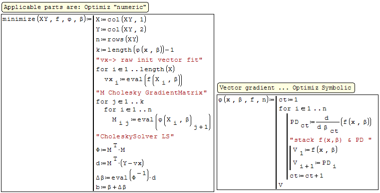

Carlos, Davide:
Here is the maths of "HyperSineCosine". The two lines in question
Have nothing to do in there Smath 5346. I know who put them first
in the module, guess: Jean ! Works fine in Smath 5346.
Interesting to cross check in latest Smath.
Maths HyperSine.sm (79.26 KiB) downloaded 1410 time(s).
#9 Posted: 7/2/2016 6:53:16 AM
Nice, works fine even in the latest SMath Studio
