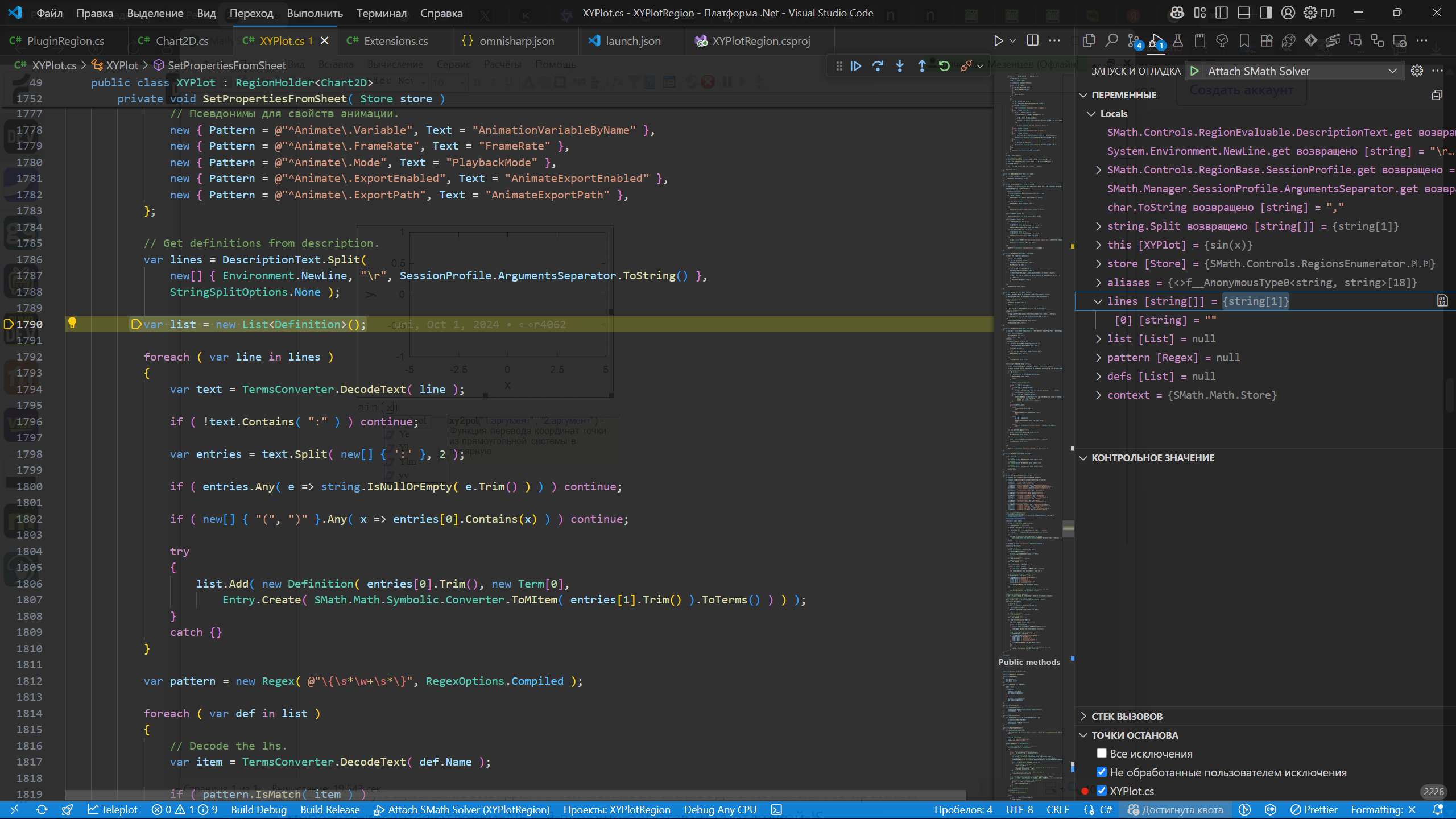

#19 Posted: 9/16/2018 7:27:01 AM
1403 likes in 1708 posts.
Automatic algorithms for saving properties you can find in NPlot Region (Settings.cs, NPlotCompact/Windows.PlotSurface2D.cs) and Opens-CAD sources (Canvas\Utils\SerializeUtil.cs, CommonTools\PropertyUtil.cs). The ideas are similar.
NPlot xml sample:
Show Spoiler
Opens-CAD xml sample:
Show Spoiler
