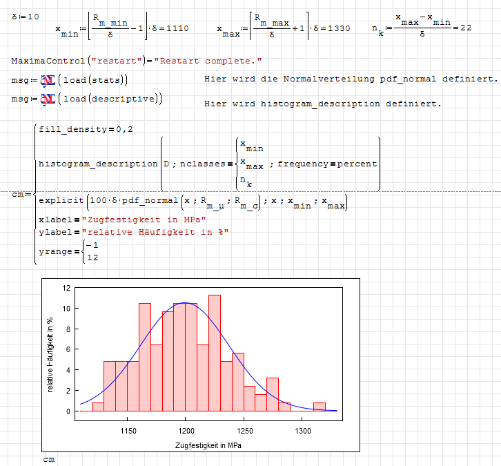

Here is an example adapted from a book on materials science with mathcad, using the maxima plugin and loading additional maxima packages.
Streuung.zip (20 KiB) downloaded 148 time(s).
frapuano 3/9/2017 8:24:00 AM
