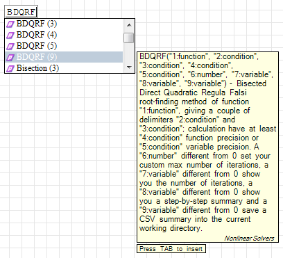

Thank you; what are the parameters of BDQRF? Very confused with the documentation, and your use of (..., 0, 0.1). I thought those were for epsilon and maximum iterations?
EDIT: Answer is found here: https://smath.info/svn/public/plugins/NonlinearSolvers/Primitives/Root%20Finding%20Methods/BDQRF.cs
trySolve(Term[] function, Term[] bound_P1, Term[] bound_P2, Term[] epsilon_fx, Term[] epsilon_Δx, int maxIterations, bool showSummary, bool saveSummary, ref Store context)
Is there any way to improve the resolution, or am I just at the limits of the double-precision floating-point?
EDIT: Previous forum posts indicate otherwise.
#4 Posted: 6/6/2017 3:52:15 PM
Better you look below for documentation; code entry point is accidentally close to the high-level function, but in general this is not guarantee
Activebook (Tools > Plugins... Interctive books - Online Gallery > Interactive SMath Handbook)
For plotting issues, I suggest to scale down the values (f.e. plot f(x)/10^19 or something similar)
