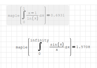

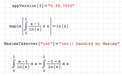

#8 Posted: 5/3/2019 2:04:37 AM
325 likes in 2052 posts.
Maple will do this, but Maxima failed in the recent nightly build.
#9 Posted: 5/3/2019 3:56:20 AM
AriosJentu
AriosJentu
0 likes in 3 posts.
Thank you. Maple works great (but slowly, because running wine). But Maxima plugin doesn't work with Linux.
