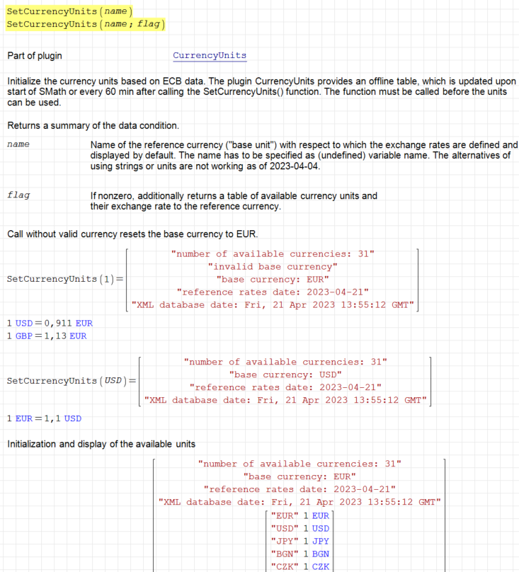

Here is an updated handbook page of the function SetCurrencyUnits().
In the current state, there seem to be some problems (filed as Bugreport SS-4686:
- SetCurrencyUnits(2) doesn't display the exchange rates
- The base unit must be specified as an undefined variable name. Units (even not the units defined by the plugin) or strings don't work.
- Russian rubles (RUR) seem to be missing.
SetCurrencyUnits.sm (19 KiB) downloaded 100 time(s).

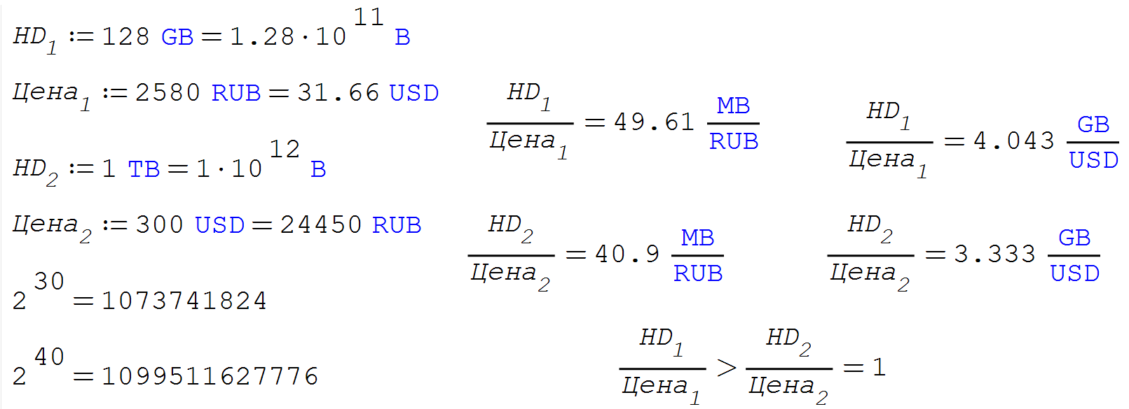

#4 Posted: 4/24/2023 12:01:03 PM
Valery Ochkov
Valery Ochkov
55 likes in 633 posts.
Click to enlarge
Thanks!
See my first calculation
