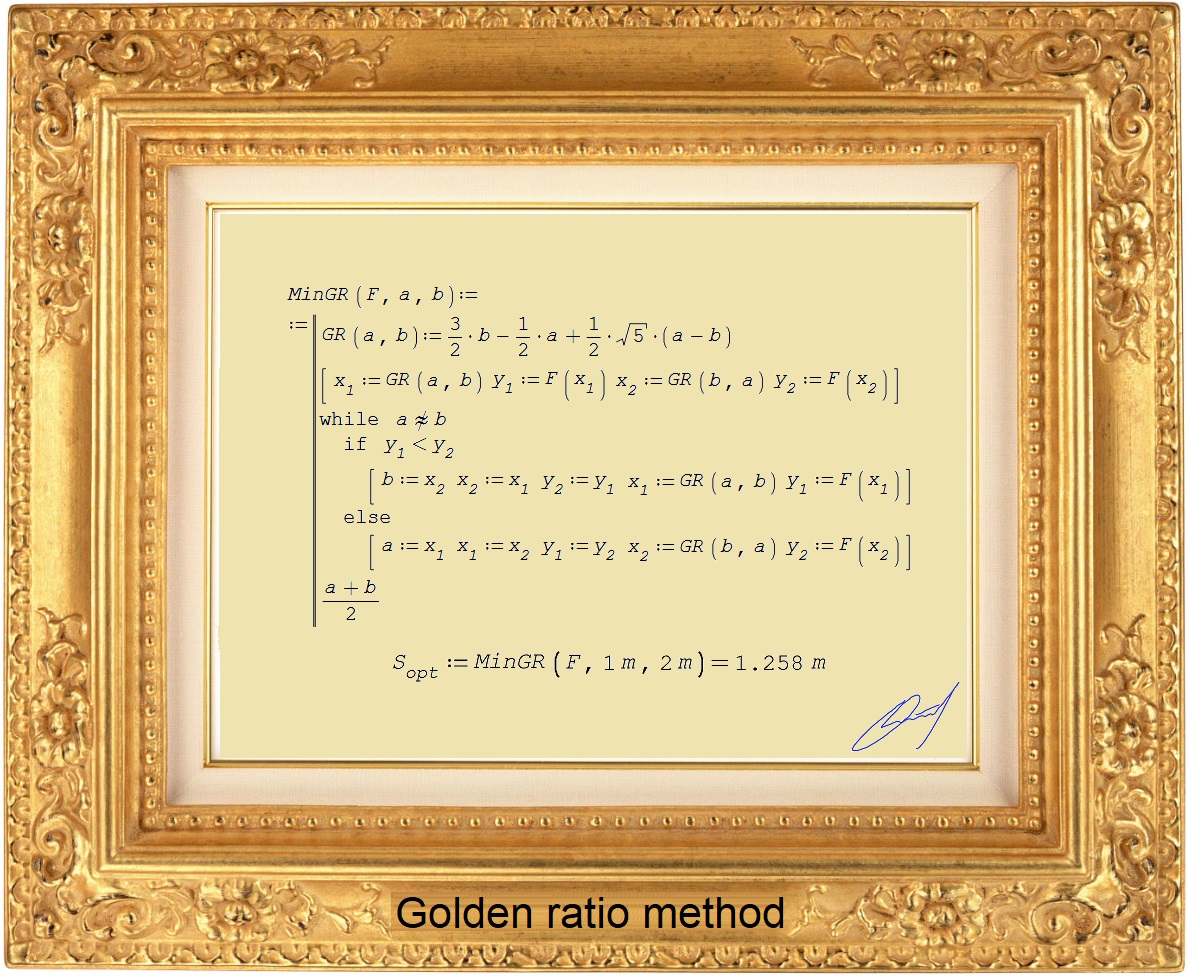

Golden Ratio Method
Golden Ratio Method - for y(x) minimize - Messages
#1 Posted: 5/3/2023 3:08:07 AM
Valery Ochkov
Valery Ochkov
66 likes in 697 posts.
3-MinGR.sm (8.97 KiB) downloaded 1509 time(s).

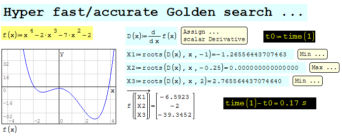

#2 Posted: 5/3/2023 8:15:21 AM
No need for approximately = ... decrease TOL as needed.
Lot more in there: roots, discrete Golden, Dichotomy ...
Golden ratio QUICK.sm (130.08 KiB) downloaded 1470 time(s).
#3 Posted: 5/3/2023 9:43:06 AM
... if your function is not symbolic differentiable for 'roots':
spline(s), all Smath based built-in ... Instead of 'roots' use solve(4)
