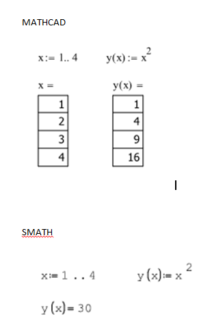

Dear SMATH users
Please help me that how to generate series or table with variable having power.
In Mathcad it is very simple
a simple calcs has been shown belwo with a variable x having power 2. In mathcad it y(x) series can be easily generated, but smath results are not same.
So guide me that how to generate similar calcs in smath.
Shafiq
#2 Posted: 4/12/2016 3:54:20 PM
Ernesto
Ernesto
13 likes in 74 posts.
You need to use the "vectorize function" over the function to get it to work.

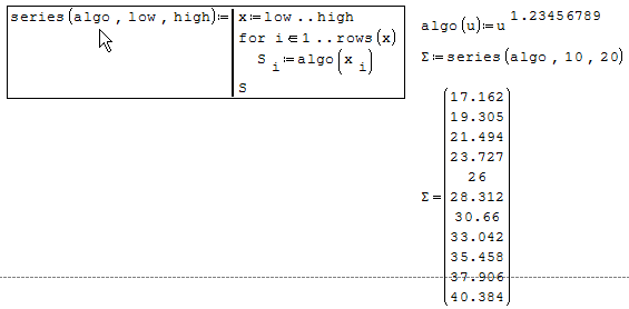

#3 Posted: 4/12/2016 4:55:02 PM
983 likes in 6866 posts.
1. Vectorise is not available in version 5346
2. Vectorise is local. For more genaral use, universal algo style
is a better choice. Plug the module at the top of the work sheet
collapse and have it in hand further down the WS.
Shafiq ur Rehman 4/13/2016 12:49:00 AM
#4 Posted: 4/12/2016 5:51:22 PM
... in the attached, where you have Vectorise(f,zoom), try to write
Z:=f(zoom) under the vectorise operator and see if it works.
But don't zap the existing working Z:=Vectorise(f,zoom).
The grayscale is in the collapsed area, no need to import.
The construction stuff is also collapsed "Fourier"
Forum Fourier Zoom Image.sm (123 KiB) downloaded 86 time(s).
