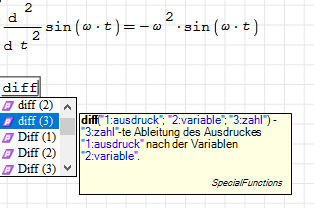

Is there the Derivative the 2-d order in SMath? I see only 1-st order.
Thanks!

It is not in the side panel but you can select it in the dynamic assistant or in the Insert functions dialog.

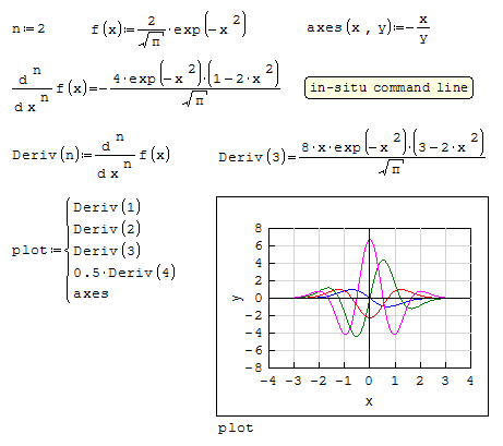

As well, you can have multiple derivatives.
f(x) is the integrand of erf(x)
Cheers ... Jean.
