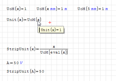

UoM was designed to act in a generic way both with symbolic and numeric data... when you use it in a inline function, since x is unknown, his unit is 1 (dimensionless - hold the mouse over the definition); if you want to use it in a inline function you have to use Units(x):UoM(eval(x)). In programming functions (when you use line), eval in the argument is not needed, because the evaluation of UoM(x) is made when you call your function.
Obviously if you know the dimensions the best approach is the one suggested in the post above (#9) by Jean.

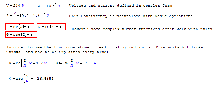

Jean here is an example showing what I mean. The functions Re(), Im() and arg() don't work when the operands have units.
By the way you may be interested in the worksheet I did for a simple AC calculation in the complex domain. it is available in the exampls section under "Engineering" and you can see it here: https://smath.com/wiki/GetFile.aspx?File=Examples/ElecEngExample.pdf

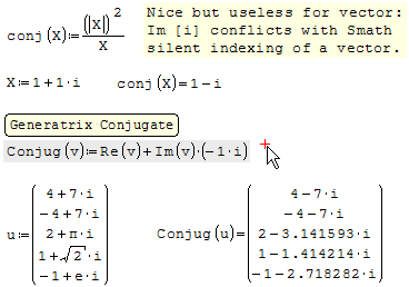

There is more than unit problem. I don't use unit
maths are unitless. BUT I append result in "UnitProject".
Years long fight in Mathcad, conclusion from collabs:
"Jean is right". ISO, Engineering ... formulas are given
wrt the unit system. Revisit the "Visual Graphic" example
just reposted this morning.

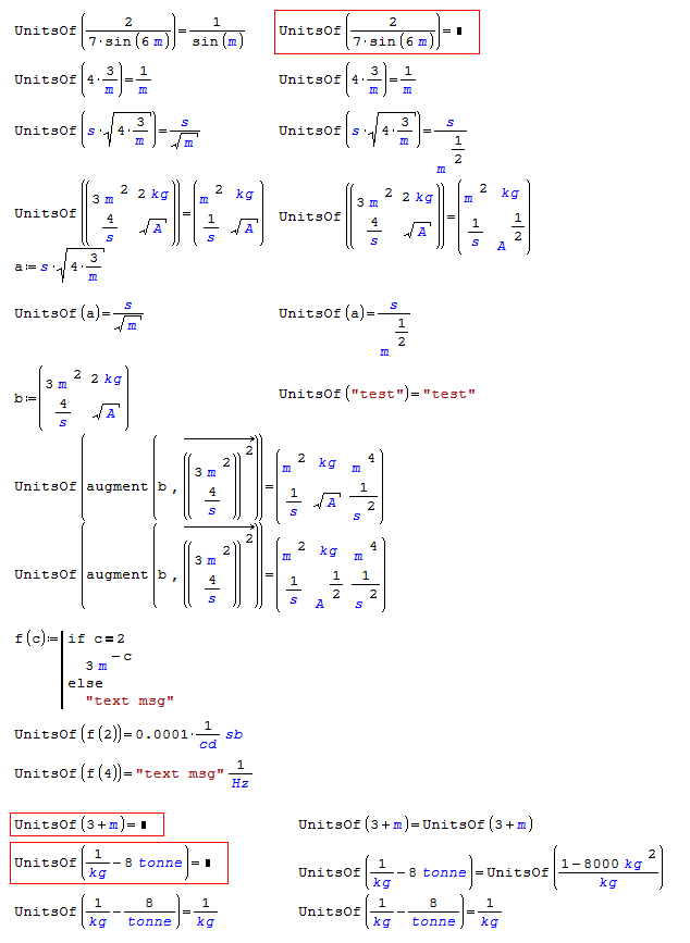

FYI: New build will contain UnitsOf(..) function which returns units of specified expression.
The following file created to test its most important use cases:
6 users liked this post
